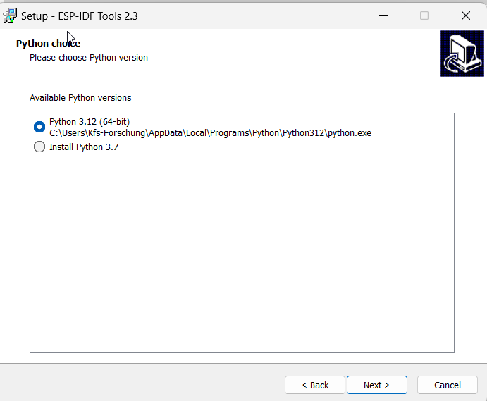

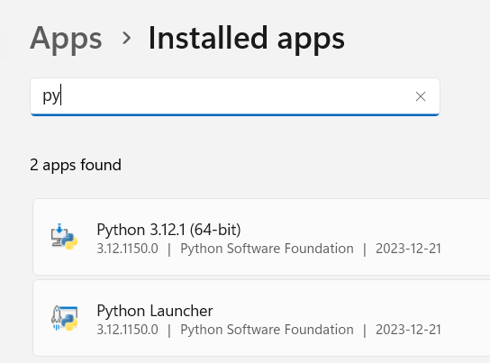

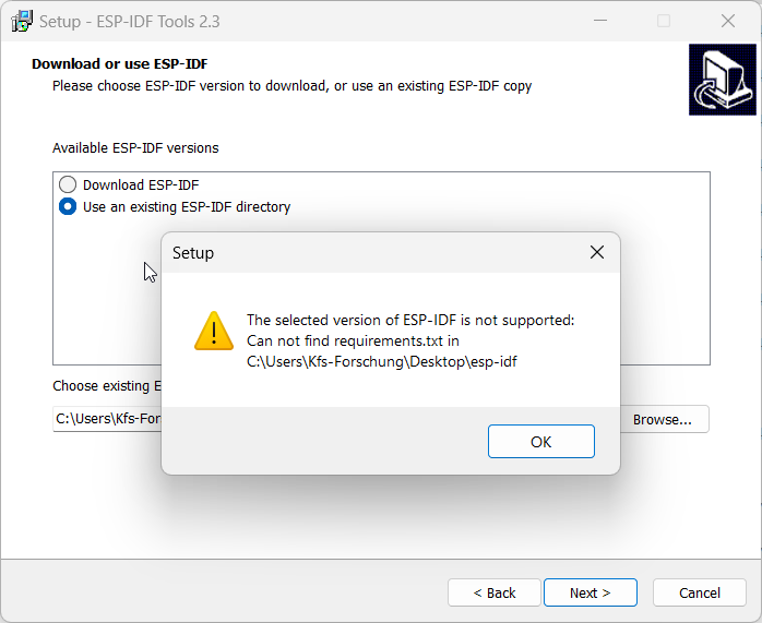

Hi to all
I have removed Python 3.7 installed Python 3.12
it's found Python 3.12
it's not found requirements...
Flowcode can not found....

Re: ESP-IdF V5.12 problem
Posted: Thu Dec 21, 2023 6:38 pm
by medelec35
Hi Stefan.
If it was me seeing that message, I would uninstall ESP-IDF and python.
Make sure both esp-idf & esp-idf-tools directories are deleted and start from fresh following the guide here.
It has not let me down to date.
I would also stick to Python 3.7

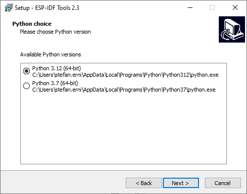

Posted: Fri Dec 22, 2023 6:55 am
by stefan.erni
Hi Martin
Yes I installed Python 3.7 again and selected it by the setup. And now it's working again.
Sooner or later we will have to change Python version and i suspect the problem is just in the toolchain check

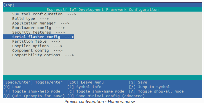

Hi to All
I am still having problems with the changeover to ESP -IDF 5.12.
The problems are not the new ESP32 C3 or S3 versions but the "old" ESP32

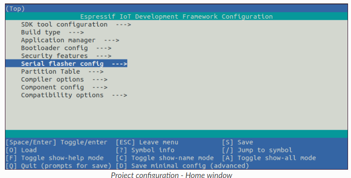

One of the problems, I cannot open the menu to setup Bluetooth.
It is also not clear to me whether I should work now with Python 3.12 or 3.7.

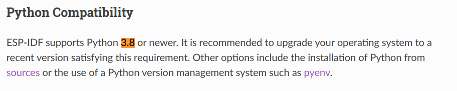

Posted: Tue Jan 16, 2024 9:58 am
by kersing
There are known compatibility issues between Python 3.11 and 3.12, perhaps you can try 3.11?
Posted: Tue Jan 16, 2024 10:27 am
by stefan.erni
Hi Kersing
Ok the menue open now with Python 3.11 and I can config bluetooth again.
The menue looks new....
