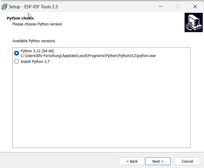

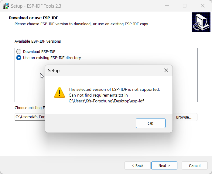

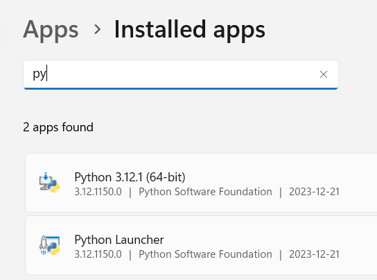

I have removed Python 3.7 installed Python 3.12
it's found Python 3.12
it's not found requirements...
Flowcode can not found....

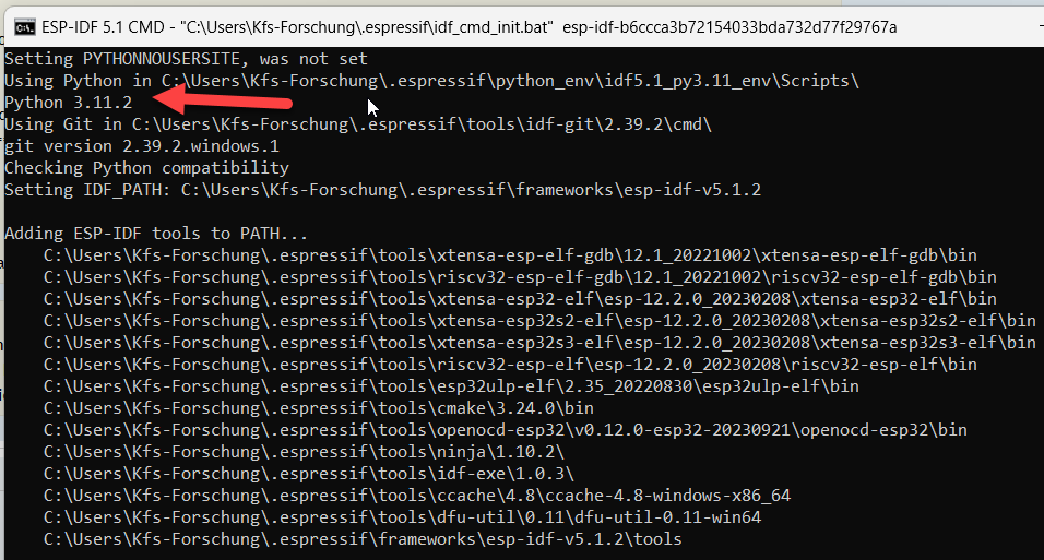

but if I type python it should show me Python 3.12
C:\Users\Kfs-Forschung\.espressif\frameworks\esp-idf-v5.1.2>python
Python 3.11.2 (tags/v3.11.2:878ead1, Feb 7 2023, 16:38:35) [MSC v.1934 64 bit (AMD64)] on win32
Type "help", "copyright", "credits" or "license" for more information.

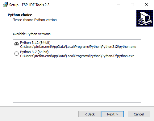

Hi Stefan.
If it was me seeing that message, I would uninstall ESP-IDF and python.
Make sure both esp-idf & esp-idf-tools directories are deleted and start from fresh following the guide here.
It has not let me down to date.
I would also stick to Python 3.7

Re: ESP-IdF V5.12 problem
Hi Martin
Yes I installed Python 3.7 again and selected it by the setup. And now it's working again.
Sooner or later we will have to change Python version and i suspect the problem is just in the toolchain check
The effort is small and makes it possible to programme the ESP32 C3 and ESP32 S3 with Flowcode. Who knows, maybe BLE.... will follow

As per this post
viewtopic.php?p=14187#p14187
I'm now running idf v5.1.2 and python 3.11 on a W10 machine. Other than compiling a basic flasher to hex I've not had a chance to do much with it.

Hi Lain
Yes idf v5.1.2 and Python 3.11 worked for the new ESP32 S3 and ESP32 C3.
But I had problems with the "old" ESP32. I could no longer configure Bluetooth. So I had to use Python 3.7 again.

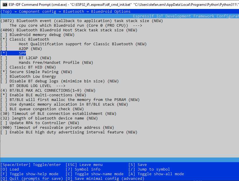

Hi to All
I am still having problems with the changeover to ESP -IDF 5.12.
The problems are not the new ESP32 C3 or S3 versions but the "old" ESP32
One of the problems, I cannot open the menu to setup Bluetooth.
It is also not clear to me whether I should work now with Python 3.12 or 3.7.
Fail Message when I want to open the menu:
menue.txt
(2.96 KiB) Downloaded 955 times

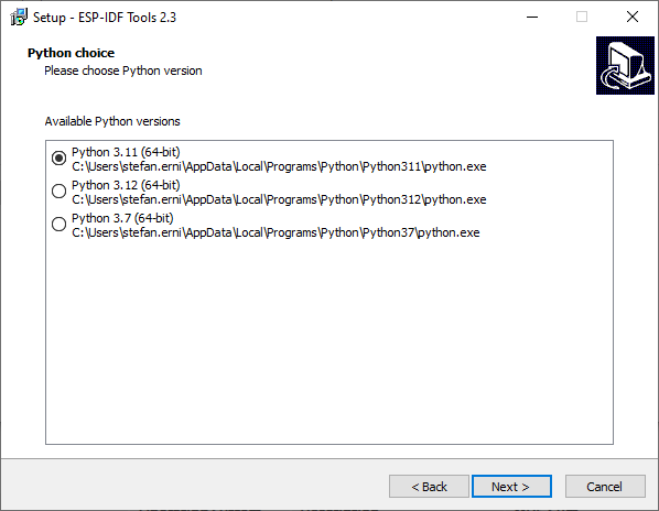

There are known compatibility issues between Python 3.11 and 3.12, perhaps you can try 3.11?
Posts: 1277
Has thanked: 245 times
Been thanked: 256 times
Hi Kersing
Ok the menue open now with Python 3.11 and I can config bluetooth again.
The menue looks new....
But now I can not compile anymore
