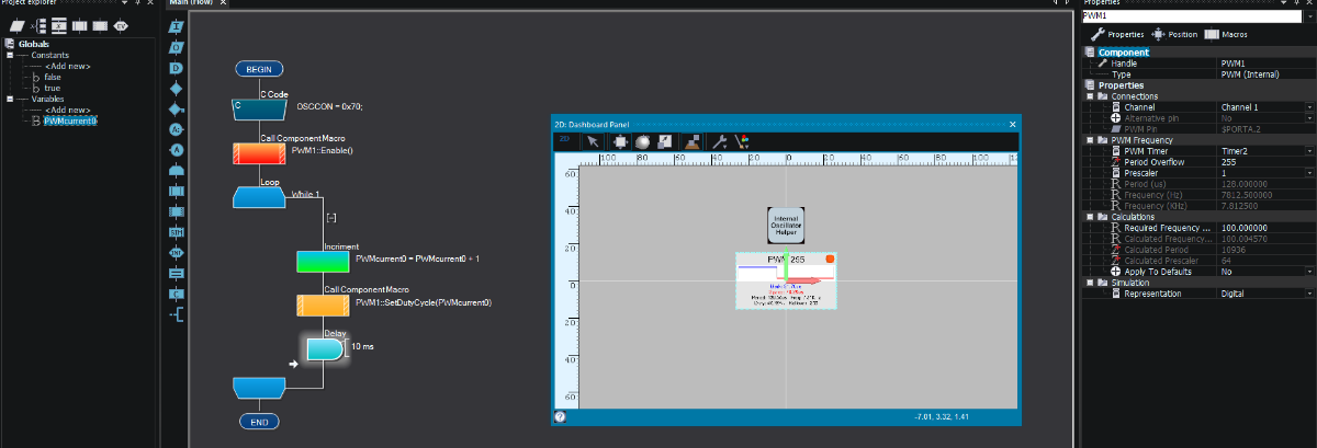

Hi All,
I have a simple program which I could not get to run on the chip, simulation was fine, I re-wrote it again with identical settings and it worked, what did I do wrong in the non-working one (Nwork) and why was the PWM image red instead of yellow?
Ben

The difference is the configuration settings in the project options. YWorks is set to use the INTOSC and NWorks is set to use an external clock.
I would also disable the watchdog timer and Low Voltage Programming options.

Ahh, awesome, great work - thanks Benj
