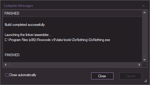

I have installed FC9 and the ESP toolchain.
A small program written and everything looks fine.

Glad it's working well and compiling ok. Let us know if you spot anything that doesn't compile.

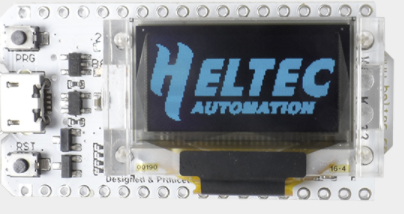

On the Heltec wifi-kit-32 is an OLED 128*64.
How can I use this OLED?
https://heltec.org/project/wifi-kit-32/

Hi Ben, Hi Leigh
Nice to hear that you have already chosen the same module.
It's working fine this Heltec Board together with the new FC9.
For my computer a have additionally to download and install this USB driver:
https://www.silabs.com/developers/usb-t ... cp-drivers
And for the Oled Display:
gLCD_SSD1306_i2c
I2C Channel 1
SDA PORTA.5
SCL PORTA.15
In the board I have, they moved the Pin from the Oled from SDA PORTA.5 to PORTA.4
and I have to set Oled RST on Pin16 to 1.
