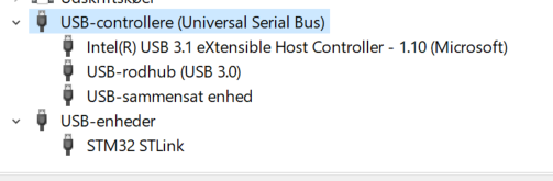

Hi Leigh
Yes I see the USB when I plug the USB. And this what I see:
Br Jorgen
Br Jorgen

Re: STM32F072
Hi Jorgen,
I thought there might be a virtual drive, in Windows File Explorer, like F:DIS_F
If not, try changing the attached file in C:\ProgramData\MatrixTSL\FlowcodeV8\FCD\ARM directory
Leigh
Leigh

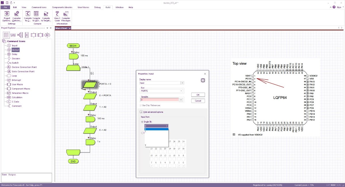

Hi LeighM,
thank you. I purchased an Fc8 +AVR (and some other pack) today, and start to use.
I working with PICs, as "hobbyst", long time ago, but my knowledge are zero related with AVR.
I attached a picture. On my F072 Nucleo board, have a "USER" button, connected to PC13.
I tried to using this port in the FC, but this (and some other) bits not available. its true for some bits on A and B too..
On Port C i can select 0,1,7 only.
What do i wrong?
What do i wrong?

Re: STM32F072
In an attempt to keep things simple,
for the Nucleo "Arduino" format compatible boards we limited the IO pins to those on the "Arduino" headers.
If you click View->Target Device you will see this and the pins available.
If you need more than those pins I will look at creating a device file for the 32F072RB chip
Did you purchase Flowcode V8 or V9?
Also, the STARM devices require the ARM pack, not AVR

Re: STM32F072
...maybe i have an idea for a simple solution(its work with all Mcu in the future): how can i switching a port/bit in C code?
- LeighM
- Posts: 2178
- Has thanked: 481 times
- Been thanked: 699 times
Re: STM32F072
You can use a Flowcode calculation icon
For example to put port C pin 13 high ...
Or this code to read the input state of port C pin 13 into a variable "Button" ...
$PORTC.13 = 1
Button = $PORTC.13
