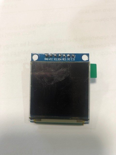

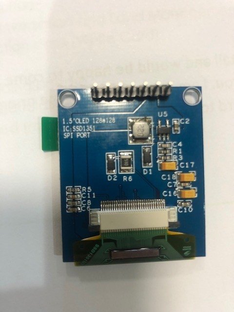

Hello i was hoping someone could help me with connecting a ESP32 Wrover to an 1.5" 128 x 128 OLED just to display temps ect.
Im not sure if i need to use SPI Master or just use the SSD1351(SPI) component or both.
In the component properties of the gLCD_SSD1351_SPI1 which is what im thinking it need im not sure how to configure the connections and also it appears flowcode has a labeling issue on the reset connection as when you hover over it, it says Instruction/Command pin connections not "reset".
Could some one please help me with the code needed just to print a string to the OLED display

Please can you post your program so far and I'll have a quick look for you.

Thank you for your reply,
Please see the attached program, its extremely basic as i just want to establish communication to the display at this stage.

Pins GPIO34 to 39 are input only and so are not capable of digital output. Can you reconnect the display to other Pins, e.g. on PORTA or PORTB 0 to 1.

Thank you I will try your suggestion and see if it works.

Thank you very much.
That worked, I can now communicate with the display you help is very much appreciated thank you again.
