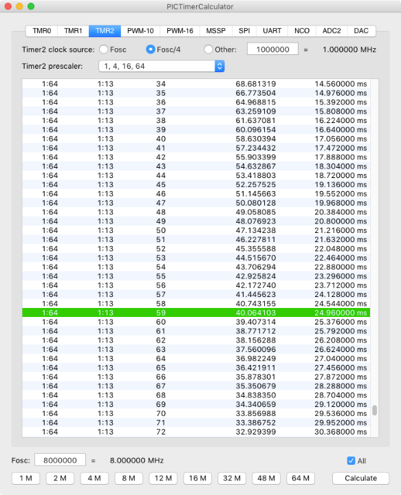

Re: TIMER 2
Try to use these values (with 8 MHz clock):
Prescaler: 1:64
Postscaler: 1:13
PR2: 59 (40.064 Hz)
PR2: 48 (49.058 Hz)
Prescaler: 1:64
Postscaler: 1:13
PR2: 59 (40.064 Hz)
PR2: 48 (49.058 Hz)
- ScreenShot_153.png (190.73 KiB) Viewed 25424 times

Re: TIMER 2
You can download the application from here (pCloud folder): https://u.pcloud.link/publink/show?code ... 0zDyoi9ySk
Please note: the application contain caclulations that are not available for every PIC microcontrollers. Check datasheet of the microcontroller. Eg.: you can use Timer 2 prescaler up to 128 but prescaler in PIC18F14K22, it can be only 1, 4 or 16.
