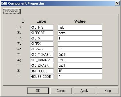

The code should now compile. Managed to spot the problem. YOu will need to fill out the values in the Custom component properties. Here are the values that I used, you can tailor these values to match your settings.

- CustProps.JPG (26.64 KiB) Viewed 9061 times
