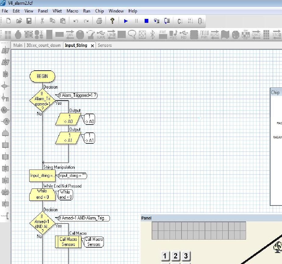

I can now understand what saschech@gmx.de is saying about he can do no more with V4. I am assuming his V4 changed so you can no longer cascade windows and it is impossible to follow flowcode by pressing F8. Same has happened to me (i was trying to export macro with arrays at the time, and knew from posts it will muck V4 up!). If you look at the screen shot:
you can see, the names of macros just under the graphic menu icons. (i screwed up in the screen shot, but could not re take since I have sorted V4 out) This means you can't select windows of macros. This is happening on ALL V4 fcf files. Just reinstalling did not solve problem.
The only way I get V4 to normally show cascaded windows or each macro was to
1) uninstall V4
2) run regedit, and delete FlowcodeV4 from: HKEY_CURRENT_USER\Software\matrixmm\
Reinstall flowcode,and back to normal. YAY
Hope that helps you Wolfgang.

From what you have explained, it appears to me that you have closed (by clicking on the "x" in the top right corner of panel window) the "Panel" and saved the file. Now the next time you load the file, the Panel window will not show up. You can restore the Panel window from the main menu View->Panel command. I hope this will help you recover the Panel on your file.saschech@gmx.de wrote: To day i start my project with v4 and i lost my panel.
Show panel is on and the property say:
size 0,871
height 0
width 871
position 871
x 60
y 865
there is no a tabbet or a window with a panel........
If i build a new project,the panel is arrive.

I have not knowingly clicked on use tabs in global options.steve wrote:Your image shows you using the "tabs" interface, which does not allow cascading of the windows. The "use tabs" setting is in project options. Perhaps this is the problem?
When I did, just before sending this email, A message is displayed 'The Tabs feature is comming soon'
Besides It could have just been a one off, so its not worth holding on to next release if I can't reproduce problem.

Ahhh.
Steve. You are correct in what you say!
If click on use tabs then that message about tabs appears. However If click on global options, restore defaults, then use tabs automatically gets ticked, then unable to cascade.
If use tabs is clicked again, then message appears about not available, but use tabs does un-tick and back to normal.. Problem solved. Thanks Steve.
I clicked on Restore Defaults. Should it have changed the way it did, since I thought the default is to be able to cascade windows, and not the other way round?

Its not really a big issue, but the bug I was referring to was when you click restore defaults, the changes made. i.e you can't have cascaded windows etc is not the default. + the clicked tabs bit.steve wrote:Yes - there is a very slight bug in that when "restore defaults" is clicked, the "tabs" gets ticked (even though it is not available).
Personally not bothered if that is sorted or not, since now I know what caused the problem in the posted screen shot is very easy changed.
