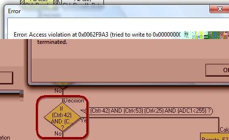

This may not be the cause, but people should be aware of.
I was getting a similar error, but it was my fault for copying and pasting formulas from one calculation box to another.
Flow code was running a simulation normally, then after adjusting Ctl pot would stop at the same point and crash with error as shown in the attachment
This was the cause of the error: (Ctrl>42) AND (Ctrl<53) (Ctrl<25) AND (ADC1<255) which was placed in a decision box.
There is nothing in between 2nd and 3rd brackets. What I should of has was: Ctrl>42) AND (Ctrl<53) only
Access error.jpg (22.23 KiB) Viewed 10320 times
After removing (Ctrl<25) AND (ADC1<255) no more crashing.
With your Flowcode, rather than just running it, try complying to hex, and see if you get any errors.
In my case I got
K:\Latest Versions only\Fans Speed Test V1.c(1647): error: missing right paren
K:\Latest Versions only\Fans Speed Test V1.c(1647): error: missing semicolon
K:\Latest Versions only\Fans Speed Test V1.c(1610): error:  failure
failure
Return code = 1
So If you run Flowcode then it stops at the same point every time, then box it stops at, could be the cause?
