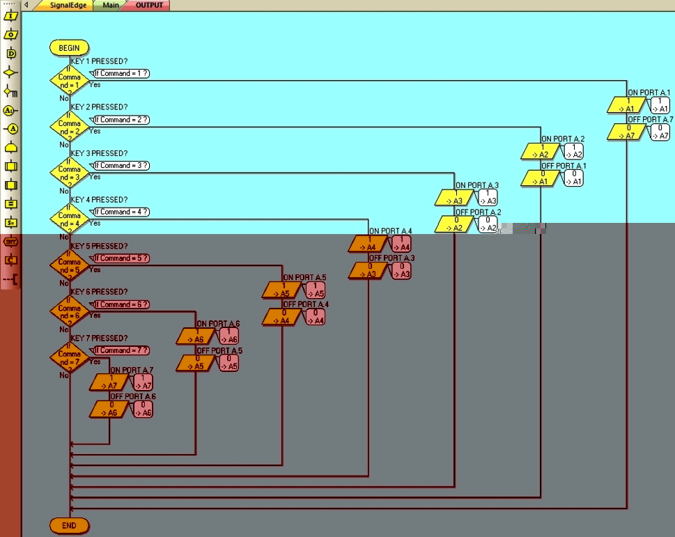

Ooops! I forgot that i can't open the attached file, because my Flowcode is for PICs and not for AVRs. I think that i can edit a flowchart (is same either for PIC or AVR, the only changed by Flowcode is the device seting menu and configuration bits) which i could upload in pictures. Your AVR is an Atmega324, right? It is similar to PIC that i use. I need some info to help you: a) which IR receiver IC are you using? b) in which port of atmega324 is connected the IR receiver? You must connect IR receiver at the mcu pin in which is allocated the Main External Interrupt. For example, in all PICs that i know main external interrupt is allocated in port RB.0 (From those i have seen in ATmega 324 datasheet, this pin might be PD.2 - INT0)
The thing starts to get some complex - against my first estimation; although the additional "macro" for decoding RC5 commands, is simple in your case. In Sean's file "RC5_INT_3.fcf_avr" there should be (like in "RC5_INT_3.fcf" for PICs) a variable "RC5cmd" inside the main program loop and after the Decision "If RC5update". Variable "RC5cmd" gets the RC5 received command value thru the "SignalEdge" macro. Inside the sub-loop there is a calculation box "Command = RC5cmd". You could edit a new macro named e.g. "Output", and insert a "Call Macro Output" box after the calculation box "Command = RC5cmd". Open the macro "Output" and edit a sub-routine consisted from 7 Calculation boxes and 6 Decisions. Example:
If Command = 1 ? --> YES (branch) --> 1->D0 (Set Port D.0) --> END (exit from macro) or NO (branch) --> If Command = 2 ? --> YES (branch) --> 0->D.0 (Clear Port D.0) --> 1->D.1 (Set Port D.1) --> END (exit from macro)
And so on.
As i told you, your case is simple because you don't need the use of "VOL+" and "VOL-" keys (RC5 commands 16d and 17d respectively). In the latter case, the synchronization of receiver and transmiter is some critical. I spent enough time to find the correct Delay time inside the main Loop (100ms for the story; with 110ms Delay, i had repeated breaks on the rotation of volume potentiometer motor).
I don't know how much i can help you with the above.
Maybe Benj
could help us a little?
And so on.

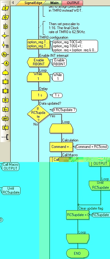

Here is a picture that shows the modified main program loop.
- RC5_INT3_main.jpg (116.17 KiB) Viewed 47487 times
Best Regards FOTIS ANAGNOSTOU

Let's suppose the following scenario: The 7 outputs that you need, are allocated in PORT A of mcu, from PA.1 - PA.7. And that, when button "1" on remote control handset is pressed, it must turn on PA.1 and turn off PA.7. In the same way, when button "2" is pressed it must turn on PA.2 and turn off the previous output PA.1. So, when button "3" is pressed it must turn on PA.3 and turn off PA.2. And so on. You can modify it, if you want e.g. when button "1" is pressed must turn on PA.1 and turn off all the rest outputs PA.2 - PA.7. Now, you have to open the menu "Macro" on the taskbar and to select "New". In the screen that will open, give the name "OUTPUT" by typing it in the corresponding box. You have to click on "OK" and imediatelly the table of the new macro "OUTPUT" will opens. There are just two icons, "BEGIN" and "END". Inside these two icons, you have to develop a new flowchart.
In the first picture you can see the flowchart of the "OUTPUT" macro developed accordingly to the supposed scenario , while in the second you can see the flowchart of the "Main" macro. You must keep the "Decision" icons as they are on the flowchart of "OUTPUT" macro. You could modify the "Output" icons according to your application, e.g. change Port A with the Port "X" that you use as output in your actual project.
Fotios
Fotios

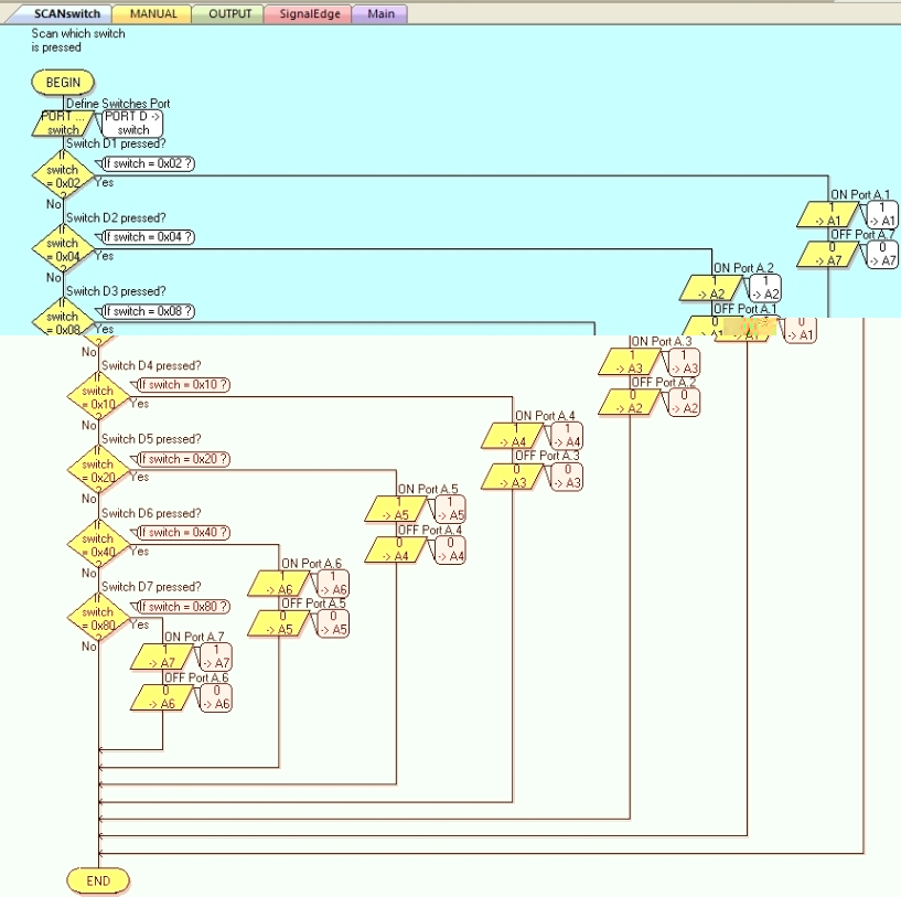

thank you so much for your help but i am finding it hard to incoparte my switch board controls to the remote control flowcodefotios wrote:Let's suppose the following scenario: The 7 outputs that you need, are allocated in PORT A of mcu, from PA.1 - PA.7. And that, when button "1" on remote control handset is pressed, it must turn on PA.1 and turn off PA.7. In the same way, when button "2" is pressed it must turn on PA.2 and turn off the previous output PA.1. So, when button "3" is pressed it must turn on PA.3 and turn off PA.2. And so on. You can modify it, if you want e.g. when button "1" is pressed must turn on PA.1 and turn off all the rest outputs PA.2 - PA.7. Now, you have to open the menu "Macro" on the taskbar and to select "New". In the screen that will open, give the name "OUTPUT" by typing it in the corresponding box. You have to click on "OK" and imediatelly the table of the new macro "OUTPUT" will opens. There are just two icons, "BEGIN" and "END". Inside these two icons, you have to develop a new flowchart.
Fotios

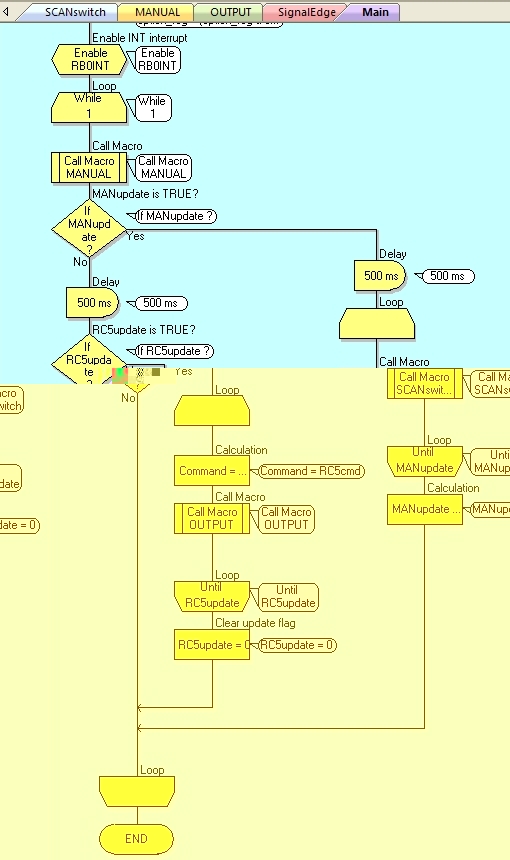

Hi soccermad.
You have confused me a bit. Now I can perceive that except remote control you also need "local" control thru 7 switches mounted on the pcb of your project. I have developed 3 Flowcharts presented in the pictures, which I will explain you step by step.
Instead interrupt, (so as the code can be applicable in any microcontroller either PIC or Atmel etc.) we use an extra loop inside the main loop for scanning if any and which of the 7 "local" switches (NOT those of the remote control handset!) is pressed. Let's suppose again that the 7 switches are connected from Port D.1 up to Port D.7 of your microcontroller. When a switch is pressed, applies a logic "1" (or +5V) at the corresponding input. Outputs remain connected from Port A.1 to Port A.7 as in the example of previous post. First of all we have to create 2 new macros and 2 new variables. You may do this:
1) Open menu "Macro" --> "New" --> type on the box the Name of the new macro: MANUAL --> click OK. Open again menu "Macro" --> "New" --> type on the box the Name of the new macro: SCANswitch --> click OK.
2) Open menu "Edit" --> "Variables" --> "Add new variable" --> type on the box the Name of the new variable: switch.
3) Do the same and create the second variable: MANupdate.
Look now at the Flowchart of macro Main on the first picture:
1. Enable INT interrupt: this command enables the external interrupt source (IR receiver) to cause an interrupt in the main program loop “Loop while 1” when receives a command from the remote control handset. When occurs, it stops the main loop and calls the macro "SignalEdge" that decodes the RC5 code received.
2. Loop "While 1": this is the main program loop and is executed continuously because we gave the value “1 = TRUE” at the start of loop. It stops only when the previously explained interrupt occurs.
3. Call Macro "MANUAL": the first step of the main loop is to change the program flow into the macro "MANUAL". Look please at the second picture the title and the structure of this macro. After the icon "BEGIN" there is an "INPUT" icon which defines Port D as input. After this, there is a "Calculation" icon: "switch = switch AND 0xFE". What means that? We make a logical AND operation between the hex number "0xFE" and the variable "switch". Hex "0xFE" is equal to binary "11111110". You may remember that we have connected the 7 switches from Port D.1 up to D.7. The last "0" of the binary number excludes from the Calculation (that is what called MASK) the Port D.0. Variable "switch" corresponds to the data register of Port D. If no one switch has been pressed, the binary number that contained in the data register of Port D is “0000000x”, thus the result of the calculation is "0" or FALSE. If any switch has been pressed the result will be different from "0" or TRUE. I hope you know few things about Boolean algebra. The result of this calculation updates the data of variable "switch". After this, it follows a "Decision" icon "If switch is TRUE?”. If no one switch has been pressed, then the variable "switch" = 0 = FALSE and thus the decision turns the program flow in the "No" branch. Then it writes a "0" (or Clear MANupdate Flag) in the variable "MANupdate". If any switch has been pressed, variable "switch" = 1 = TRUE and the program turns in the "Yes" branch, where it writes a "1" (or Set MANupdate flag) in the variable "MANupdate".
4. In either way, the program returns to the main loop (See again at the first picture) where it has to pass thru the Decision icon "If MANupdate is TRUE?”. If any switch has been pressed, then the variable "switch" = TRUE --> variable "MANupdate" = TRUE, so the program turns in the "Yes" branch of the decision "If MANupdate?”. In the flow of “Yes” branch there is a delay icon “Delay 500ms”. Later, during the test of program in your actual hardware you can delete this Delay or to modify it according to instance.
5. Loop “Until MANupdate is TRUE”: You have to create this sub-loop. The test if the condition of loop “MANupdate is TRUE” is fulfilled (i.e. a switch has been pressed) is placed at the end of the loop. This means that even if the switch is held down, the loop will be terminated and the program returns in the start of the Main loop. With other words, if a switch is pressed this sub-loop is executed at once and it calls each time the macro “SCANswitch”. We have seen that in the macro “MANUAL” is detected if a switch was pressed. In the macro “SCANswitch” is detected which switch exactly was pressed. Look at the 3rd picture: In the beginning of macro, is placed an “Input” icon that defines Port D as input for the 7 switches. After it, are arranged 7 “Decision” icons. Each icon corresponds to one switch. Each switch when is pressed, it writes in the Port D register a unique binary number:
Switch D1 = 00000010 b = 0x02 hex
Switch D2 = 00000100 b = 0x04 hex
Switch D3 = 00001000 b = 0x08 hex
Switch D4 = 00010000 b = 0x10 hex
Switch D5 = 00100000 b = 0x20 hex
Switch D6 = 01000000 b = 0x40 hex
Switch D7 = 10000000 b = 0x80 hex
According to the switch pressed, the corresponding “Decision” icon it turns the program flow at its “Yes” branch. Then, the program activates one output and deactivates another one, exactly like in the macro “OUTPUT” which is presented in my previous post.
You should be careful about the “Delay” of 500ms placed before the “Decision” icon “If RC5update is TRUE?". The 14 bits of RC5 code are transmitted in repeated and predetermined intervals, so the correct response of the program to decode the RC5 command received – for that is the macro “SignalEdge” - is time critical. According to your application, you could change this delay to e.g. 200ms. You will find this during the test of the complete program on your actual project.
I hope the above will help you a little better now.
Fotios
