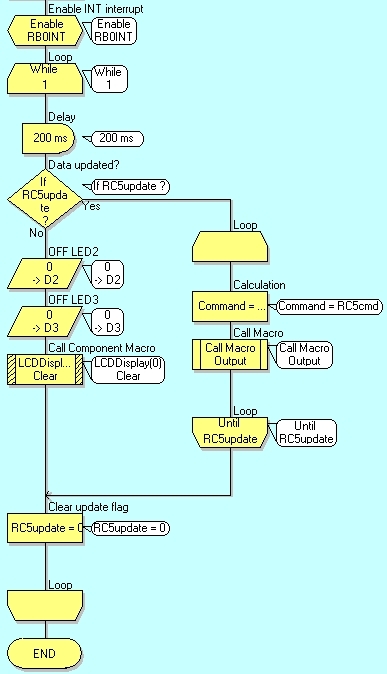

You should be able to use the RC5update variable for your volume control. The handset will transmit the key value at regular intervals if a button is held down, so the program will detect multiple messages. The RC5update value is set to 1 in the interrupt handler each time an RC5 message is successfully received, and is cleared in the main program when it is detected. Your program should only respond to the address and command values each time RC5update is set.
The example program uses the decision icon - If RC5update - to detect the reception of a message and the requirement for an action.

If Command = 1 ? --> YES (branch) --> 1->D0 (Set Port D.0) --> END (exit from macro) or NO (branch) --> If Command = 2 ? --> YES (branch) --> 0->D.0 (Clear Port D.0) --> 1->D.1 (Set Port D.1) --> END (exit from macro)
And so on.
As i told you, your case is simple because you don't need the use of "VOL+" and "VOL-" keys (RC5 commands 16d and 17d respectively). In the latter case, the synchronization of receiver and transmiter is some critical. I spent enough time to find the correct Delay time inside the main Loop (100ms for the story; with 110ms Delay, i had repeated breaks on the rotation of volume potentiometer motor).
I don't know how much i can help you with the above.

Re: MX010 - RC5 remote control
Here is a picture that shows the modified main program loop.
- RC5_INT3_main.jpg (116.17 KiB) Viewed 65540 times
so where would i insert the output function boxes for the interaction for the switch boardfotios wrote:Here is a picture that shows the modified main program loop.
- fotios
- Posts: 458
- Joined: Mon Feb 08, 2010 10:17 am
- Location: Greece
- Has thanked: 109 times
- Been thanked: 117 times
Let's suppose the following scenario: The 7 outputs that you need, are allocated in PORT A of mcu, from PA.1 - PA.7. And that, when button "1" on remote control handset is pressed, it must turn on PA.1 and turn off PA.7. In the same way, when button "2" is pressed it must turn on PA.2 and turn off the previous output PA.1. So, when button "3" is pressed it must turn on PA.3 and turn off PA.2. And so on. You can modify it, if you want e.g. when button "1" is pressed must turn on PA.1 and turn off all the rest outputs PA.2 - PA.7. Now, you have to open the menu "Macro" on the taskbar and to select "New". In the screen that will open, give the name "OUTPUT" by typing it in the corresponding box. You have to click on "OK" and imediatelly the table of the new macro "OUTPUT" will opens. There are just two icons, "BEGIN" and "END". Inside these two icons, you have to develop a new flowchart.
In the first picture you can see the flowchart of the "OUTPUT" macro developed accordingly to the supposed scenario , while in the second you can see the flowchart of the "Main" macro. You must keep the "Decision" icons as they are on the flowchart of "OUTPUT" macro. You could modify the "Output" icons according to your application, e.g. change Port A with the Port "X" that you use as output in your actual project.
Fotios
Fotios
thank you so much for your help but i am finding it hard to incoparte my switch board controls to the remote control flowcodefotios wrote:Let's suppose the following scenario: The 7 outputs that you need, are allocated in PORT A of mcu, from PA.1 - PA.7. And that, when button "1" on remote control handset is pressed, it must turn on PA.1 and turn off PA.7. In the same way, when button "2" is pressed it must turn on PA.2 and turn off the previous output PA.1. So, when button "3" is pressed it must turn on PA.3 and turn off PA.2. And so on. You can modify it, if you want e.g. when button "1" is pressed must turn on PA.1 and turn off all the rest outputs PA.2 - PA.7. Now, you have to open the menu "Macro" on the taskbar and to select "New". In the screen that will open, give the name "OUTPUT" by typing it in the corresponding box. You have to click on "OK" and imediatelly the table of the new macro "OUTPUT" will opens. There are just two icons, "BEGIN" and "END". Inside these two icons, you have to develop a new flowchart.
Fotios
