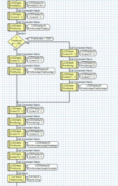

Hi Danny, I don’t know if this will help you but I just broke the number down and did two PrintString’s to the LCD for numbers each side to the decimal point. I did a third PrintString (“.”) write for the decimal point.

Hi Werner,
I can't make out what the 4th macro from the bottem says: PrintNumber(length..?..digit)
Also I think the first one at the top says: PrintASCII("AT:") is this correct...what I mean is It's hard to read..

It says "LCDDisplay(0)Printumber(TotalPc)" TotalPc in reference to one of my variables.DannyBerry wrote: I can't make out what the 4th macro from the bottem says: PrintNumber(length..?..digit)
Yes Danny, you are correct. For my program I needed a reference as to where something was so i stated for example: "AT: 15.75" like 15 3/4" inch. If I get time I will have a look at your program tonight.
