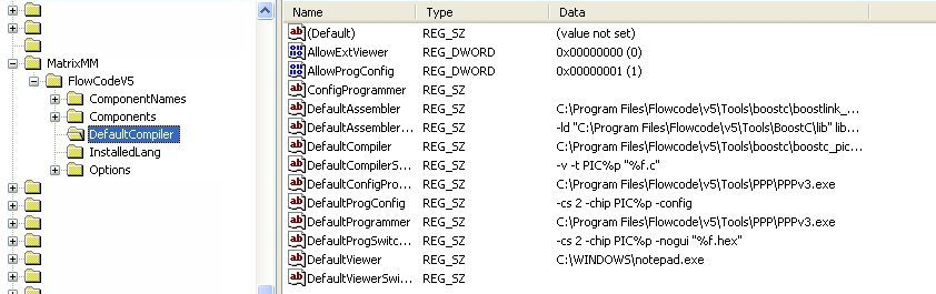

Just a bit of extra info, my registry settings for my Flowcode 5 instalation.
thanks
Acestu

Hi Stuart
That config error has been mentioned on several earlier posts on the forums.
Its nothing to be to concerned about.
If I remember its something to do with having more than one version of PPP on the system.
Re: Need Help with NEW Dev board Please
I believe the fix is available from here.
http://www.matrixmultimedia.com/mmforum ... G8L#p32373

Yes I did some searches Ben and found that workaround, I only have one copy of ppp on my laptop and it still does it.
This as you know only happens when you use ppp as a standalone application.
Right my chips have come, I have reinstalled Flowcode and updated the ppp software to 3.14 which is what John & Enamul are using.
So I am going to try programming with the Dev board, fingers crossed.
