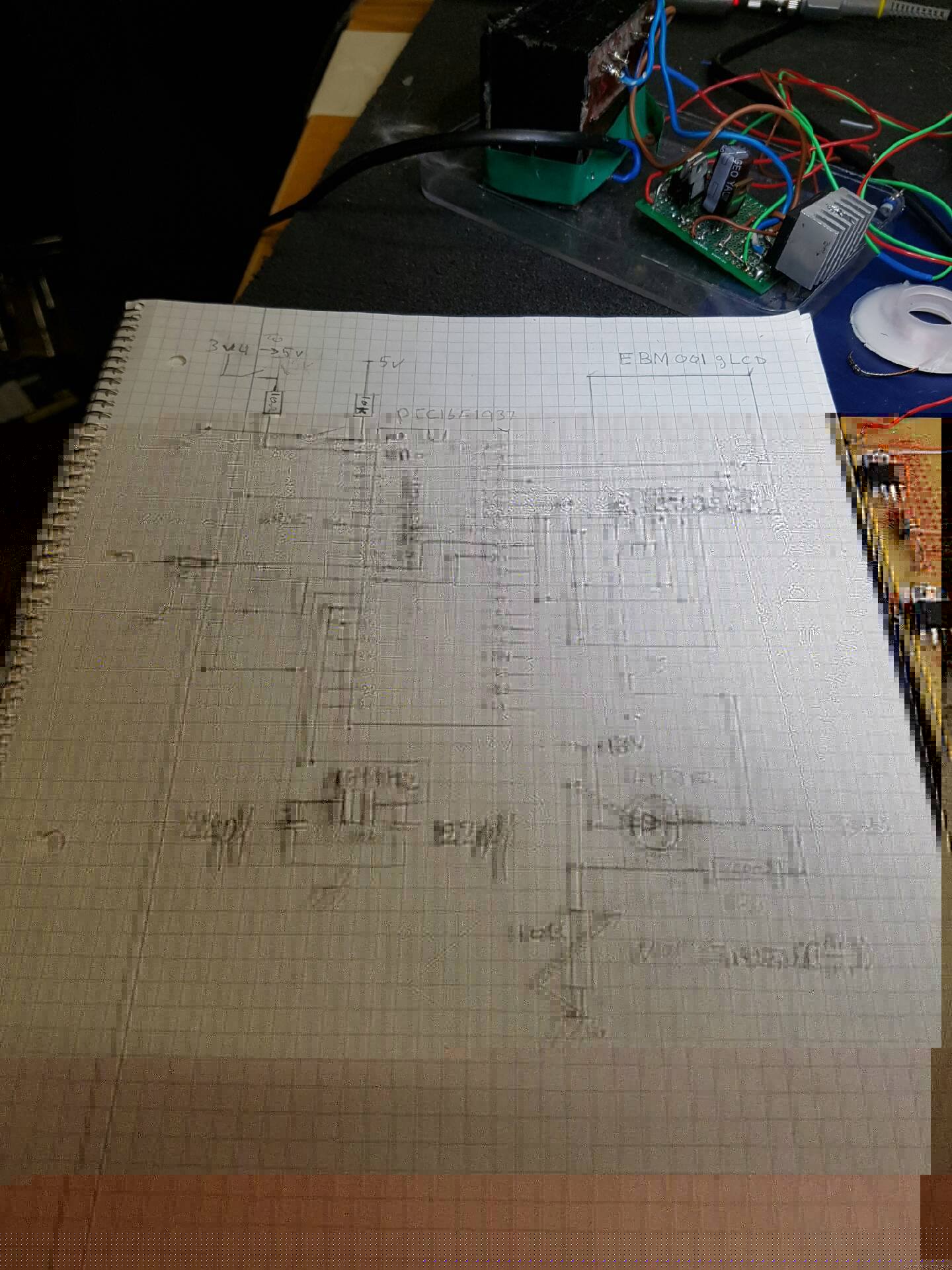

the connections of the attached diagram shows the pin (1) of the IC is connected to 5v1 through a 10K Resistor & a switch to GND
I have also set a text "Good luck" it shows after every sec
I hope I will be able to make this work I have been using allots your time & mine
with regards
Nasim

Re: To get gLCD working
Hello Nasim,
Few comments on your schematic.
1) Where does the 5V come from?
2) Why doesn't the 3V3 voltage come from the 5V, currently it comes from an 18V source? 18V dropped to 3V3 is 14.7V to try and burn off as heat, quite a task for any regulator.
3) What is the current rating for F1 which I assume is a fuse and not a resistor. I can see that 10 Ohms has been erased, there should be no resistance on the 5V line.
4) One of the oscillator pins is fed back to pin 6, I don't think this is allowed and will likely cause the oscillator to fail.
5) Have you measured the 5V and 3V3 voltage rails to make sure they are actually 5V and 3V3?
Also
How are you programming the chip? Are you using one of our boards (EB006) or are you using a PICkit or other 3rd party programmer?

thanks BenJ
I have only one DC out put of 18 volt ,1A.
it has been divided for what was needed
sorry that I only sent you one part of the processors circuit diagram
the 5v1 is an output from stablizer L7805cv = 5v1 ,500mA
3v3 to 5 is the out put is from : L7805cv+10ohm R+ 3v3 Zenor diode
out put is= 4v36
pin6 has been tried connected & disconnected to clock output pin the result the same
Now it has been disconnected for ever .
I think the problem is the programmer first I bought 3 types of matrix programmers.
they are : EB064-00-1, EB-006-00-7 , EB-006-00-8 unluckily they don´t work with my laptop
there for I bought a DATAMAN-40PRO you can see the results
there for I asked Miss Nichola for the right USB connectors she has directed me to by an adopter from Amazon
I did n´t have an account with Amazon I made the order for some other place so I wait now .
please see my attached docs if you have the time for it
(275.05 KiB) Downloaded 1584 times
(105.13 KiB) Downloaded 1584 times
