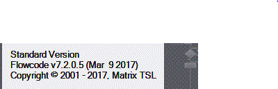

What version of Flowcode are you running? (Menu Help->About Flowcode)

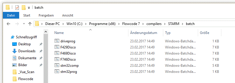

Could you look in your Flowcode7 installation directory, in \compilers\STARM\batch and see if you have the file F429Disco.bat
saschech@gmx.de
Posts: 714
Joined: Wed Jan 31, 2007 12:41 pm
Has thanked: 1 time
Been thanked: 26 times
Re: error code -1
Post by saschech@gmx.de »
hello
