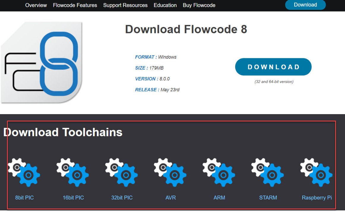

jgu1 wrote:First, what is the toolchain, is this something I have to buy also?
No the tool chain is the compiler which was previous included in the Flowcode installation now you have to down load the compiler"Toolchain" desperately and install it ,you down load the once you use for example you use AVR then you down load the AVR Tool chain and not the otter ones.
Go to Flowcode >> download and at the bottom of the page you will see it
