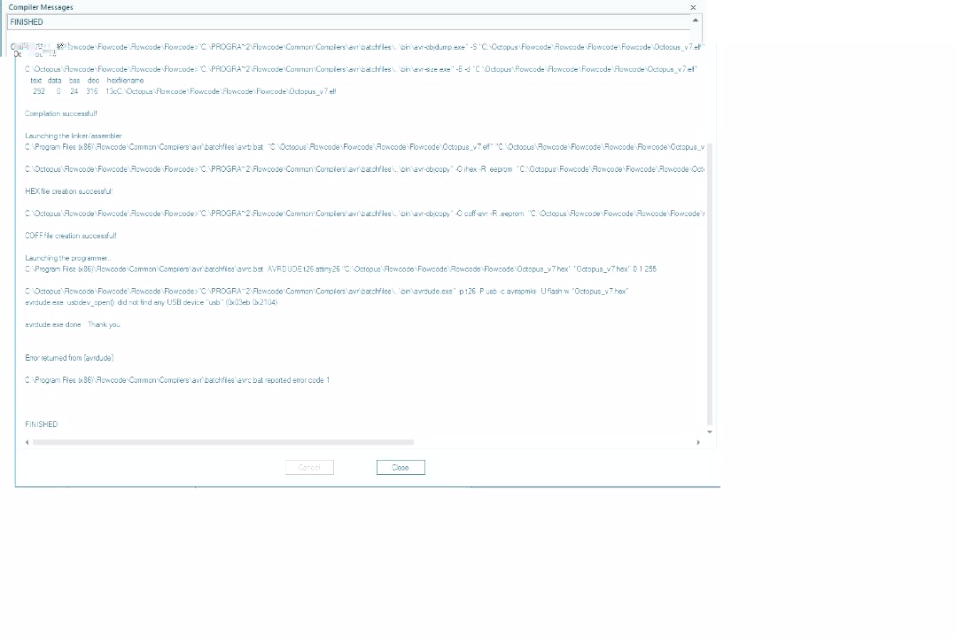

I am thinking of upgrading from V4 to V8 so playing around with the free 30 day trial version.
I am using the AVRISP mkII programmer and when running V4 all is good.
However it fails to recognise the chip when running V8 (see picture below)
Any help appreciated !!!!
Iain

Re: Trialing Flowcode 8 programmer problem
Looks like you will need to edit the default programming parameters to use the AVRISP mkII. We currently default to the AVR TinyUSB.
Simply click on Build -> Compiler Options.
Select the Programmer tab.
Click the save icon and give the new configuration a name, e.g. AVRISP
Ensure you have the new configuration highlighted and ticked as set to default.
Then change the programmer path and parameters as shown here.
https://www.matrixtsl.com/wiki/index.ph ... VRISP_mkII
Let us know how you get on.

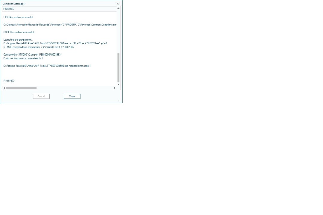

Hi Benj,
Did that but now it doesn't seem to find the programmer on the USB !!!
Programmer is plugged in and does enumerate ..... also still works fine in the V4 Flowcode.
Any more ideas ???
Snapshot of error attached
Iain
It could be a driver issue, I believe Flowcode 4 worked with an earlier version of the AVRISP mkII USB driver.
There is a newer signed driver available from the "Flowcode 8\Drivers\AVRISPmkII" folder which hopefully should work fine with v8 and also not break the v4 installation.

Hi Benj,
Ok updating the driver worked for V8 but doesn't work on my V4 !!!
Hello Iain,
Glad v8 is now able to program, rolling back the device driver will allow v4 to work again. The USB driver for the AVRISP is very messy and I'm very glad we have now moved away from it as our go to AVR programmer. The USB tiny has no driver issues
Regarding updating projects from v4 to v8. This is a big jump in terms of components and devices etc and so the fact there are some problems is probably not that unexpected. I would check things like component properties and interrupt icon properties. If these are all ok then hopefully the programs will work as expected.
