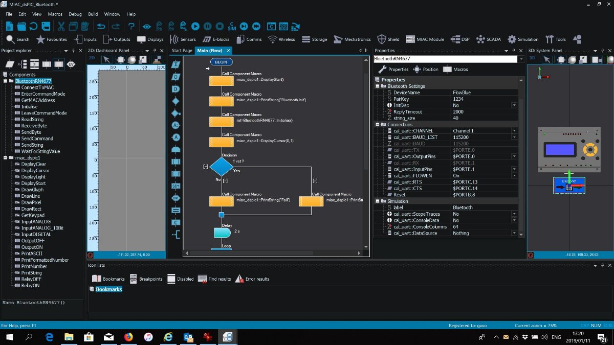

Hi Benj,
Please see attached Screen Grab of the Set-Up, I assume the Baud rate is 115200?

Re: dspMIAC Bluetooth
Post by LeighM »
57600
TX E.4
RX E.3
Flow Control Off
