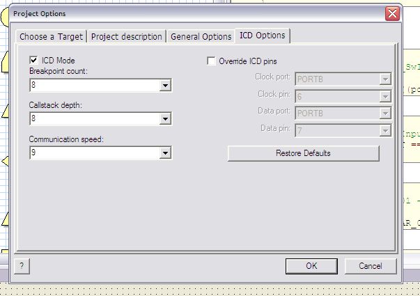

Am unable to get ICD working for the above chip. FC5 simulation and flashing of code to micro are deemed to be working well.
Although ICD options in PROJECT OPTIONS tab have been activated,
ICD Active in Project Options.jpg (43.42 KiB) Viewed 5407 times
I cannot establish connection/comms to the chip (ICD compatible chip). Pls suggest possible fix.

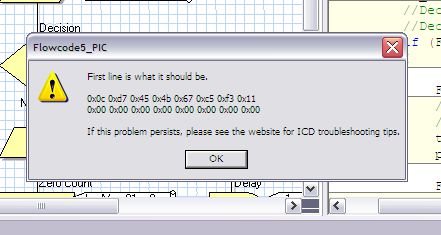

When trying to establish connection via the DEBUG TAB the following errors are reported:
Error msg on ICD attempt.jpg (25.7 KiB) Viewed 5407 times
Compliler messages are appended for your inspection.

Ben, sorry I sent you the incorrect file. Have checked the original C file and ICD stuff seems to be there. Have even tried it with a new code set and have appended this file for your perusal. Result is still the same with previous error message saying that
"ICD has failed to communicate with the target. Make sure the target is powered correctly, then reset it and try again"

I have double checked that 'Backgroud Debug' has been Enabled. Recompiled all the files without any success. There does not appear to be any comms issues with programming & Auto-detect when running Flowcode or PPPv3. Only ICD still fails and the same error is reported. When I click "YES" the second line is still filled with 0x00.

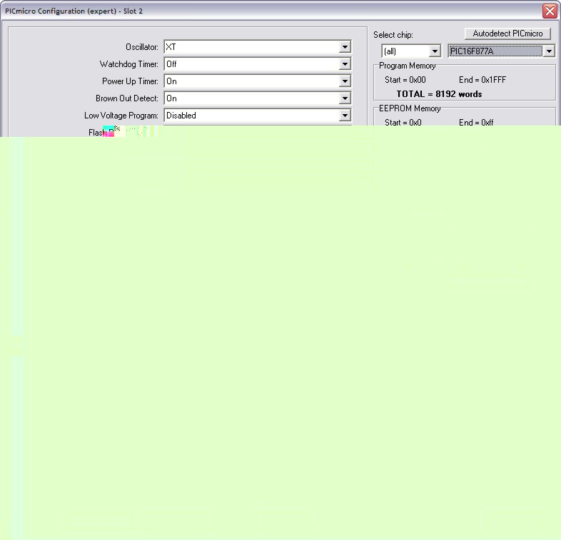

Decided to tweak Oscillator and Comm speed settings as I noted that some of my LEDs were flashing on stepping into program in Debug Mode before nuisance error was reported.
Hardware: Removed default crystal for 4MHz, set SW2 to OSC and Power to EB006-00-8 defaulted to PSU
Flowcode: Build Tab--> Project Options
Clock Speed : 4000000 (Mhz)
--> ICD Tab, Comm speed: 200
Back to General Options Tab--> Configure Chip settings as follows: (Note Background Debug has been DISABLED not enabled)
(84.55 KiB) Downloaded 1150 times
And finally --> Options:
Build Tab --> Compile to Chip.
...finally the ICD works.
At this juncture I am attributing my problems to sync due to the comms and clock speeds. Pls feel free to comment :P
