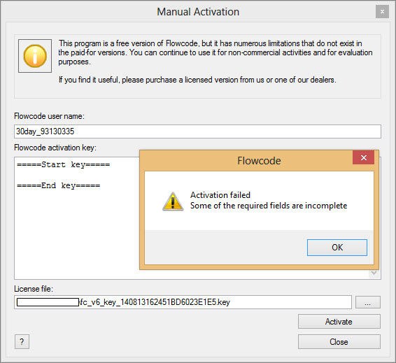

Manual Activation not working !!

Just as shown in attachment
- 14-08-2013 19-19-11.jpg (82.37 KiB) Viewed 16044 times

have you tried to activate by adding your username and password from your new matrix account (the one you created to download beta)
Manual activation will only work if you have a lic file

Re: Manual Activation not working !!
I think Dave has posted on the website about an issue with the .key file. This is the file that provides you with all your license information and at the moment is downloading an empty file - he is looking into that, hopefully it will be resolved soon.
