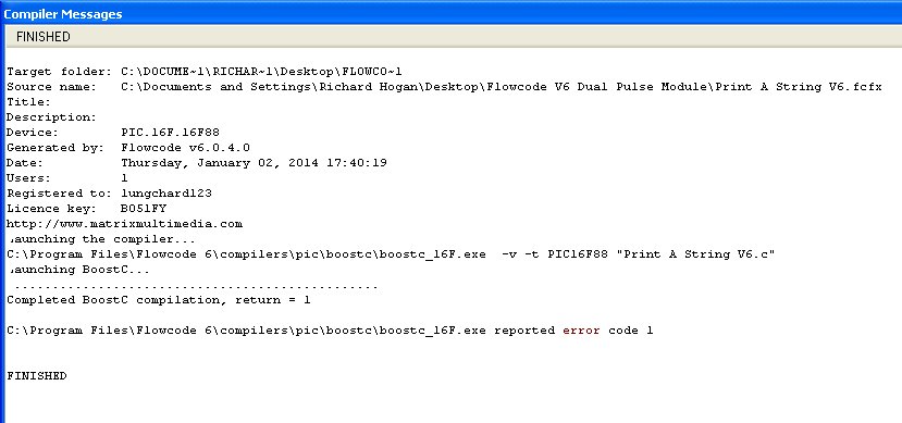

I get compiler error when i use the format txt = string test. Txt is my string variable and test is my ulong variable.
See attached file for error message info.
If i use txt = ToString$ (test) it does compile but LCD shows wrong value if test variable is longer than 5 digits.
Compiler Error.jpg (57.49 KiB) Viewed 6016 times

If i use the format txt = string test then i get compile error as per your previous mail (error: ',' expected).
