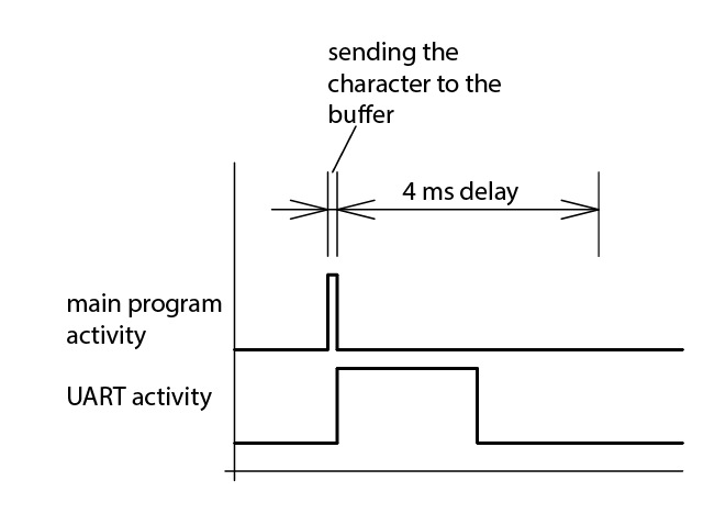

Not sure if this should be in the bug report but I am having strange behaviour when using the delay function in conjunction with a UART.
As you can see from the flowcode image a 4mS delay is placed between UART sends but on the logic analyser image, measuring target hardware, it is actually 2mS. This is with a baud rate of 9600. Changing the baud rate to a higher speed makes the delay longer and it gets close to 4mS at 115200.
My clock is defined correctly at 16MHz.

The flowchart command sends the charaters to a buffer (SW, HW, both?) then waits 4 ms, the main process does not wait for the UART module to finish the job. This is why you see more pause at higher UART baudrate. I think.

Thanks I understand now

If you wanted to wait until the UART byte has finished being sent before starting your delay then you could use this following C code in a C icon.
UART Channel 1
while (TXSTA1bits.TRMT);
UART Channel 2
while (TXSTA2bits.TRMT);
