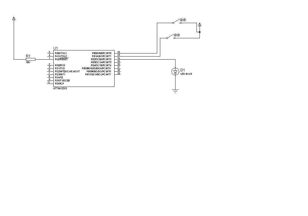

I also tried with attiny 2313 works on AVR board but dont work on my experimental board. What am I doing wrong.

Also you have not got pull down resistors on any of the switches,
It's vital they are fitted!
When compile with FC7 hardware does not work.
Is that correct?
Re: pROBLEM WITH 12f629
This program doesnt work either on FC6 or FC7. I put resistors just didnt draw it on schematics.

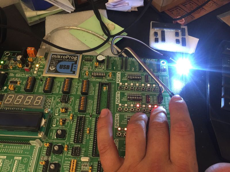

Here is picture where you can see that it is working on EASY AVR board , but when I put it on experimental board it doesnt work.
