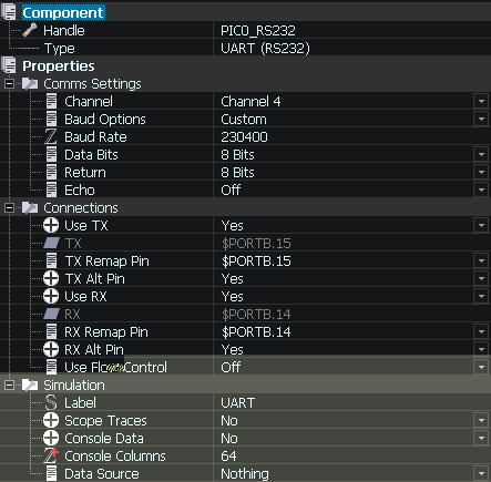

Just to say that I obviously have run into this problem as well. We have not tried Software UART option (in case this works for some reason) as we need the RXINT though.
Our MCU FYI is PIC32MZ1024EFE100
The only solution at the moment is to modify the Flowcode settings to match the real life. Simply multiply by 4x the baud rate used, set the Baud Options to Custom and enter the new number into the Baud Rate field for the UART Component in Flowcode 8.
SO TO MAKE IT CLEAR FOR OTHER PEOPLE RUNNING INTO THIS PROBLEM...
Say you use baud rate 57600 (our case). Simply multiply this number by 4x which equals 230400. And enter this new number in the Flowcode properties window as below. The clocked UART output stream runs exactly at 57600bps :D
Hope this helps, regards!
