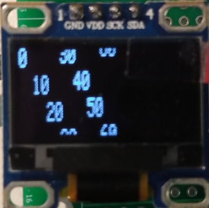

I tried to get understanding the results shown on the gLCD:
It seems like the gLCD is not 64x128, but 32x128
I did also a simulation in Flowcode which resulted in:
This looks more as expected for a 64x128 gLCD. Or is there something else what can explain the first picture?
Kind regards
Jan
Re: I2C GLCD start problem
Hi Jan,
Yes it looks like the resolution of the display is only 32 pixels high assuming you are using font size 0.
Looks like it might be only 32 x 64.
