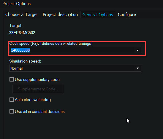

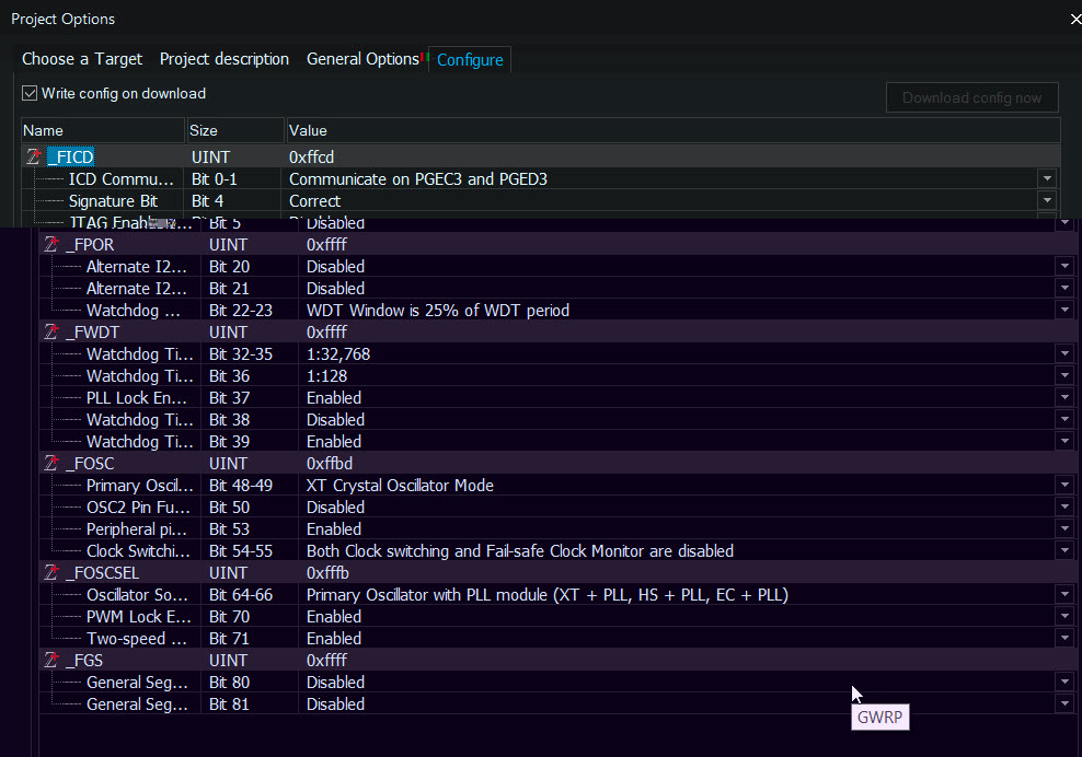

use a C icon enter the c code and place the C icon before the main loop so that it is execute on start up only
here are the settings for Project option
