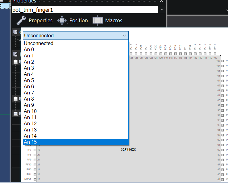

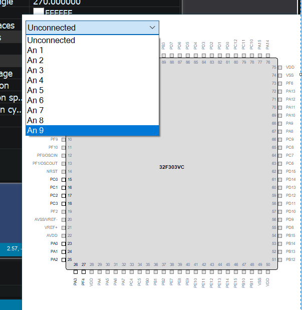

Today I have start developing the code for analog channels with STM32F446ZCT6 and STM32F303VCT6 components and I found some mismatch in ADC pins in both STM MCU components. Can you please help to check and update it?
Below are the details:
As per datasheet STM32F303VCT6 MCU has 39 channel ADC. But Flowcode component has only 9 Ch ADC.
As per Datasheet STM32F446ZCT6 MCU has 24 Channels ADC. BUt Flowcode component has only 16 Ch ADC.
In our project, we used all the ADC AI pins in both Chip. So please help to resolve these issues. Thanks.

- STM32F446ZCT6 has very less AI pins.PNG (44.81 KiB) Viewed 7595 times
- STM32F303VCT6 very less ADC.PNG (45.06 KiB) Viewed 7595 times

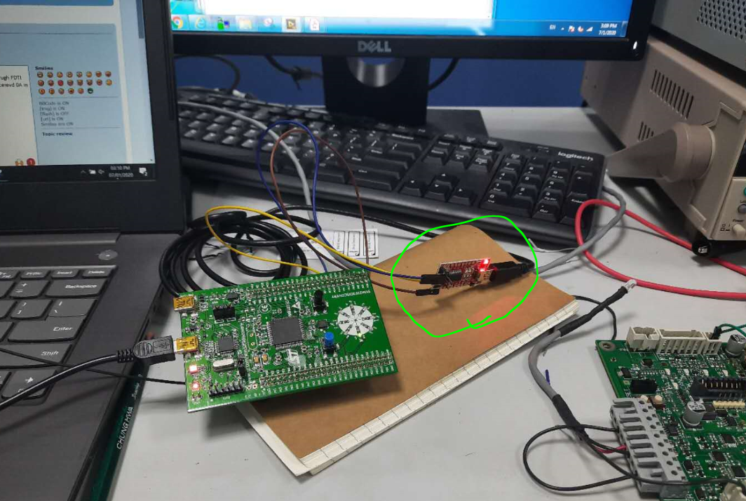

Re: Add STM32F446ZCT6 ARM MCU in component library
Hi LeighM,
Thank you very much for your fast reply. Also, I need another help. How to communicate the ARM MCU's UART port component directly through FDTI TTL UART adaptor (without using MAX232 IC)? I have tried to communicate but FDTI receives wrong Data. If MCU sends string "1" computer received 0A in Hex. Please guide me on how to communicate the MCU directly without any inverter IC(MAX232).
In our product, there is no Max232 inverter IC circuit populated and our product FW directly communicates through UART (TTL) through FDTI chip. For testing the ADC value (I will develop the FW through Flowcode and communicate through FDTI), I need to use the same TTL method in our Functional Tester.
Thanks in advance.
Karthick
Thanks in advance.
Karthick

- uart.PNG (965.78 KiB) Viewed 7584 times
Please try these ...
32F446ZC.fcdx
C:\ProgramData\MatrixTSL\FlowcodeV8\FCD\ARM
STARM_CAL_ADC.c
C:\ProgramData\MatrixTSL\FlowcodeV8\CAL\STARM
32F446ZC.fcdx
STARM_CAL_ADC.c

karthickefy
- Posts: 74
- Joined: Thu Nov 30, 2017 3:21 am
- Has thanked: 4 times
- Been thanked: 9 times
Hi LeighM,
Thanks. I downloaded .FCDX file into the specific folder and now I can see all the ADC pins for STM32F446ZCT6 part. I will check ADC tomorrow and update you the result.

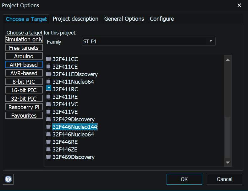

Also I verified all STM32F446ZET6 and STM32F446 Nucleo discovery board (Which has STM32F446ZET6 Chip)component and these components also have the same ADC pin count issues. It will be good if you correct all.
Thanks for your support.
Karthick.

karthickefy
- Posts: 74
HI LeighM,
If you update the STM32F446ZET6 parts similar like STM32F446ZCT6, I can test it now in my home and update you on the result immediately.
I have STM32F446 Nucleo board on hand and I can test now. Please check.
Karthick.
Karthick.
- LeighM
- Posts: 2178
- Has thanked: 481 times
- Been thanked: 699 times
Thanks, here is the 32F446ZE
- 32F446ZE.fcdx
- (61.69 KiB) Downloaded 196 times
