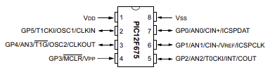

I tryed a lot of things but with no luck. I using Flowcode V5
I have a pic 12F675 powered by a single 4.2v lithium battery.
I need to measure voltage of this battery to change 3 states of a simple led:
If voltage is over 3.7v (read as a byte, for example 227) led is on.
If voltage is minor to 3.69v (read as a byte, for example 226) led is blinking.
If voltage is minor of 3.2v (read as a byte, for example 200) led blinking faster.
I use a voltage divider to take the sample of battery by Pin 6 (GP1/Vref) using a 5k resistor.
I use ADC component conected to ADC GP1.
I use a simple component to call ADC and set variable as a byte.
Then I evaluated this variable to make I want.
But not work. In deed never I can make work this using single battery to feed pic and evalauating same battery.
Some idea? Thanks a lot.
Is your pic on the battery or do you have a 3.3volt psu additionally ?
Maybe you mean two 5k resistors

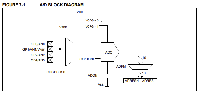

You are using Vref as reference Voltage on pin 6
and which pin is for the AD input?
You need a stable voltage for vref (not dependent on the battery) that can be done with a small Ic with 3Pin, or you use a regulator for the PIC for 3.3volt and use VDD as Vref.
or to test the battery you can use the included comparator but I think flowcode don't support it.
read in the manual:

Ok, so, first of all, is needed one fixed voltage equal or below 5V in order to this work, is correct? Without one fixed voltage, is impossible made measure. Maybe (and simply [In my case is not critical the accurate of measure]) with one zener...

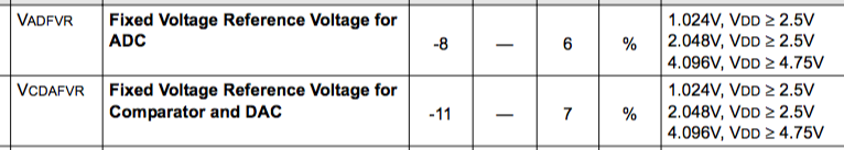

Yes, you need a fixed reference. It can be external or if you choose another controller (eg. PIC12F1840), can be internal.
I don't recommend zener diode as a voltage reference, it's not stable.

Oh, it's a good option this 12F1840. But how can I enable it in Flowcode? I still seeing just 2 options, VDD and VRef, this 12F1840 have 3 options, how I can enable FVR in Flowcode?

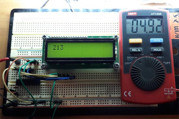

Today I've learned a new trick. :)
Setup the ADC:
Vref+: Vdd (AVdd)
Vref-: Vss (AVss)
Setup FVR to 1.024 V
Measure FVR voltage by the ADC module. Because FVR is fixed, you can calculate the PIC's own voltage. Tested with PIC18F14K22, surprisingly accurate. Important! With this PIC, using 1.024 or 2.048 V internal Vref, Vdd can't be lower than 2.5 V, see datasheet! As you can see the attached pictures, the results are not linear and the internal Vref can be drift, but far good enough to detect low voltage if you're using a fixed value to compare the ADC results.

Sorry guys, forgot the example. Here it is, tested on real HW. Flowchart written in Flowcode v6 (I don't have newer), but you can find the required C codes in the report file.
PIC18F14K22_OwnVoltage_report.zip
(20.04 KiB) Downloaded 412 times
PIC18F14K22_OwnVoltage.fcfx
(5.12 KiB) Downloaded 399 times

Looking at the datasheet, that device does not have an internal FVR that can be used for analogue inputs. It has an internal comparator reference, but I'm not sure if that is supported in Flowcode (but you can always use C code if you need it).
More modern chips (like the 12F1840) do have an internal FVR.

For that device, you can use an external voltage reference for measuring voltages without C code.
Using the chip's comparator is relatively easy in C code - you should only need a couple of lines to setup the CMCON and VRCON appropriately, and then another line to read the COUT value from CMCON. All the rest can be done using flowchart icons.
The values of the registers depends on your requirements, but CMCON=0x04 sets it to compare GP1 with the internal reference (which is set by VRCON). Read COUT by setting a variable to (CMCON & 0x40).
