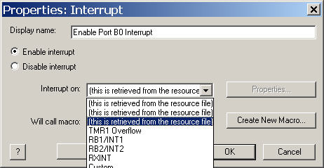

I am looking for a PORTB-change interrupt for PIC18F452, but I cannot find it in the interrupt selection menu.
What I do find however is 3 times "this is retrieved from the source file".
What does this mean and which one is the PORTB-change interrupt?

Here is a replacement definition file that will fix the problem for you. Simply close Flowcode and copy the file into your "Flowcode V4/FCD" directory.

Thx Benj, it works now.
