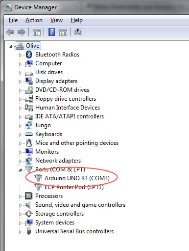

The first step is to ensure that you have installed the Arduino drivers for your USB device, these are available from the Arduino site. Once you have installed the USB drivers the device should appear within your Windows device manager.
To access device manager:
Control Panel >> System >> Device Manager
The Arduino device should be listed under the “Ports (COM & LPT)” heading within Device Manager.
device manager
If the device is not listed it may not be connected correctly or the drivers may not be installed. Please check connections and drivers if you do not see the device in the list.
At this point you should note down the COM port that the Arduino is connected to in the above example this is COM port 3… COM3.

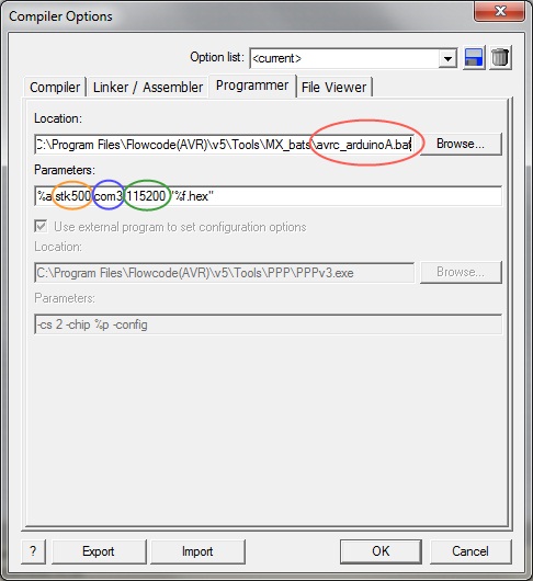

With these files in the correct place we now need to change the compiler options to represent the Arduino we are using.
Red Circle: changed compiler options to point to new batch file
Orange Circle: Change to ‘programmer’ value obtained from text file
Blue Circle: Change to COM port that device is attached to
Green Circle: Change to ‘speed’ value obtained from text file
Now when you click compiler your Arduino should program correctly!
