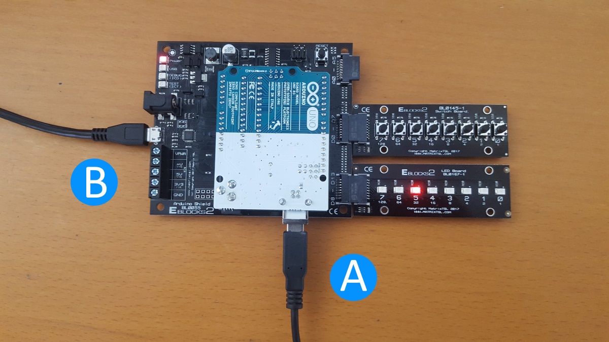

2. Plugging in the device
The picture above shows two USB plug in points:
Point A: This plug in point can be used to power the device when programming is not required, however if programming of the Arduino device is required this cable MUST be plugged in to allow programming of the Arduino.
Point B: This plug in point can also be used to power the device when programming is not required, however it CANNOT be used for programming the Arduino. It is however required when using the Eblocks 2 debugging tool 'Ghost'.
So in summary:
A:
  - Power
  - Programming
B:
  - Power
  - Debugging

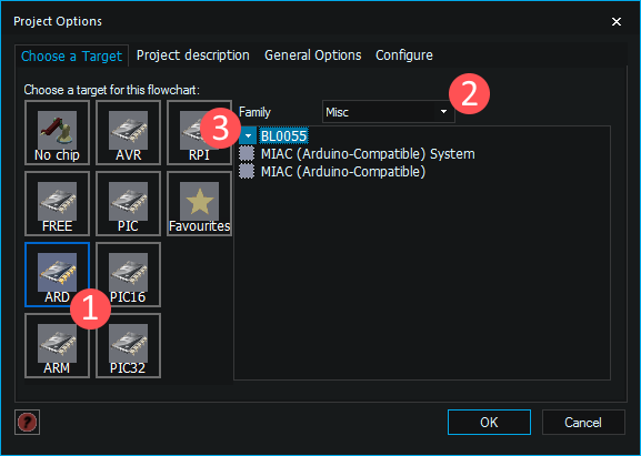

First thing is to select the appropriate Arduino device within Flowcode:
1. Select the ARD (Arduino) Chip Pack
2. From the dropdown select "Misc"
3. Select the BL0055 device

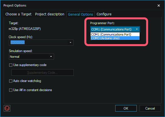

Next make sure to setup the Arduino device as a target, ensure the device is plugged into USB connection point 'A' in step 2, and then go to Build >> Project Options in Flowcode.
Where it says "Programmer Port", ensure that the Arduino device is selected.
You should now be good to go!
