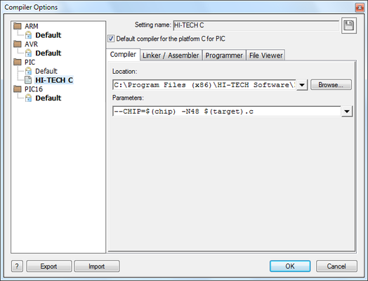

HI-TECH C Compiler
Compiler location
Sets the Compiler location.
Default 10/12/16F:
C:\Program Files (x86)\HI-TECH Software\PICC\PRO\9.83\bin\picc.exe
Default 18F:
C:\Program Files (x86)\HI-TECH Software\PICC-18\PRO\9.80\bin\picc18.exe
Compiler parameters
Adds command line parameters when called from Flowcode
Default:
--CHIP=$(chip) -N48 $(target).c

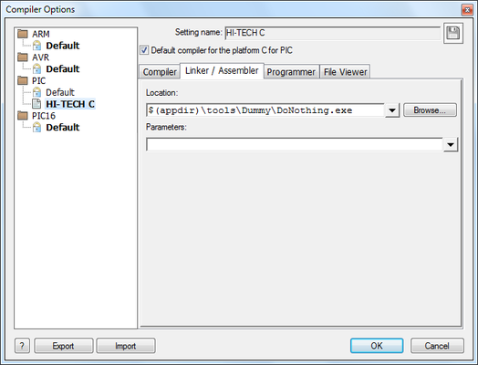

HI-TECH C Linker/Assembler
Linker/Assembler location
Sets the Assembler program location.
Default:
$(appdir)\tools\Dummy\DoNothing.exe
Linker/Assembler parameters
Default:
<empty>

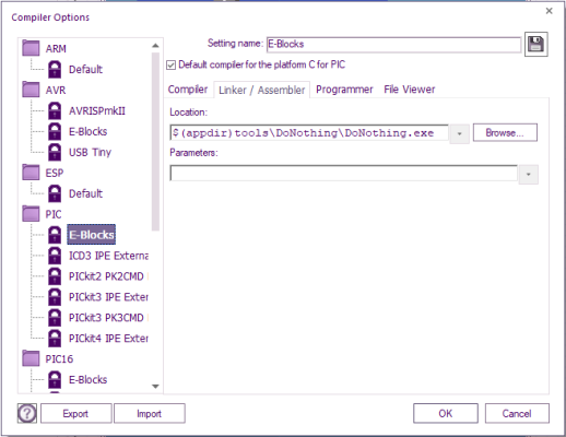

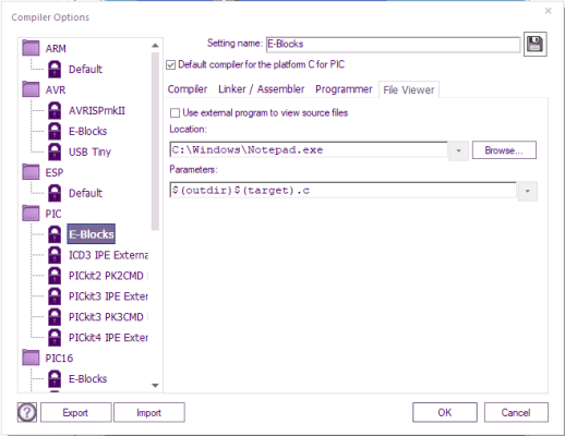

File Viewer
File Viewer location
Sets the File viewer location for viewing C and Assembly files.
Default:
C:\Windows\Notepad.exe
File Viewer parameters
Adds command line parameters for the File viewer program
Default Assembly file viewer
$(outdir)$(target).asm
Default external program to view source files
$(outdir)$(target).c
