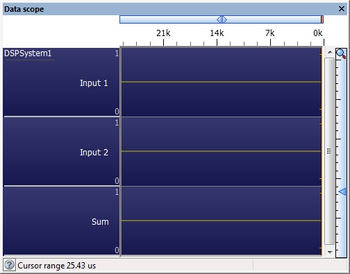

| + | The DSP system initialise function must be called in your program before any other DSP component macros are called as it sets up the buffers ready to be used. The initialise function also sets up the scope window so if you like you can see the DSP signals during simulation to help debug or visualise what's going on. | ||
| + | [[File:DSP5.jpg]] | ||
