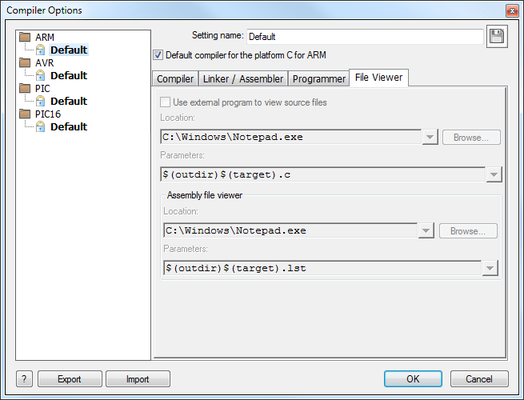

File Viewer
File Viewer location
Sets the File viewer location for viewing C and Assembly files.
The default is empty, this activates the use of the internal C code viewer.
Default:
C:\Windows\Notepad.exe
File Viewer parameters
Adds command line parameters for the File viewer program
Default Assembly file viewer:
$(outdir)$(target).lst
Default external program to view source files:
$(outdir)$(target).c
