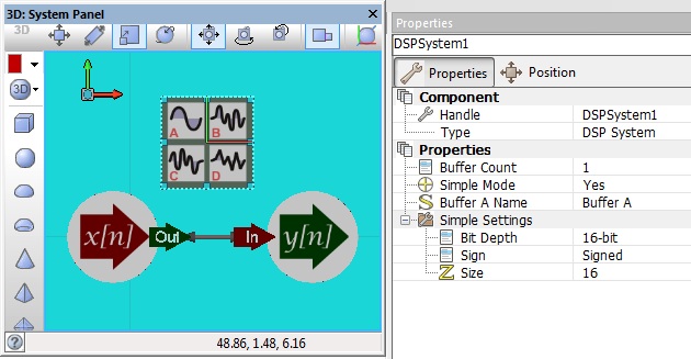

The DSP components all centre around the DSP System component which is basically the buffer manager for the system. For each link between components we need a buffer, think of each buffer as a pipe that the data can flow along. The size of each buffer dictates the number of operations or "ticks" that have to happen before the data reaches the end of the buffer. If we know the "tick" rate of the system and the size of the buffer then we know the delay that will be presented when the data is travelling through the buffer.
For example if we have an input component connected directly to an output component then we need only one buffer.

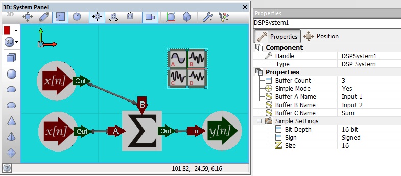

If we have two input components connected via a sum component and then onto an output component then we need three buffers. Naming the buffers can help when it comes to connecting everything up.

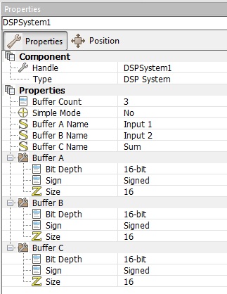

By default all the buffers have the same bit depth and sign but by disabling the simple mode property these can be manually edited for each individual buffer.
Components are connected up to the buffers by specifying the buffer manager and then selecting the buffer.
