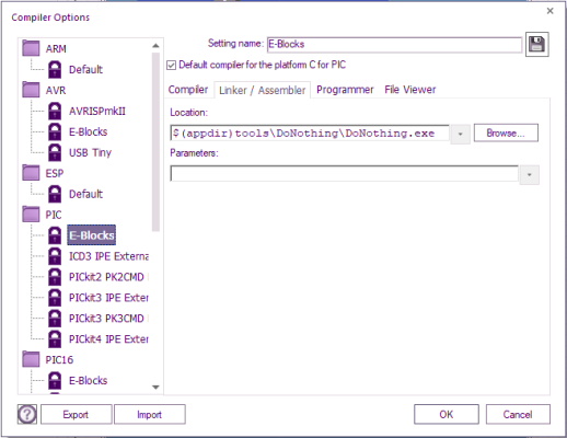

PIC XC8 Linker/Assembler
Linker/Assembler location
Sets the Assembler program location.
Default:
$(appdir)tools\DoNothing\DoNothing.exe
Linker/Assembler parameters
Adds command line parameters when called from Flowcode
Default:
