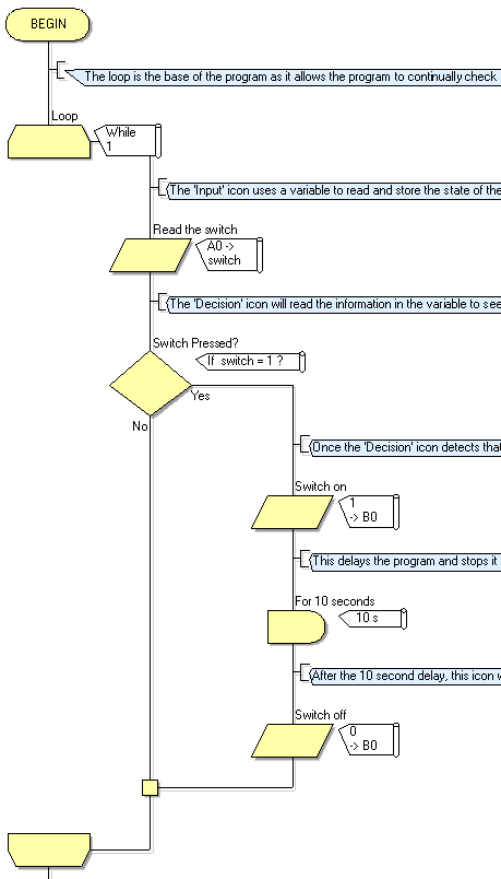

Adding comments
- Drag a Comment icon onto the flowchart above the 'Loop' icon.
- Double click the 'Comment' icon to open up the Comment Icon Properties dialogue box.
- Explain the purpose of the loop and how it is the base of the process.
- The loop is the base of the program as it allows the program to continually check if the switch has been pressed by repeating the process of detecting the state of the switch.
- Add a comment above the 'Input' icon.
- Open the icon properties by double clicking on the 'Comment' icon.
- Describe the use of the 'Input' icon and how it reads the state of the switch.
- The 'Input' icon uses a variable to read and store the state of the switch, this allows the information contained in the variable to be used to see if the switch is being pressed or not.
- Comment and document the 'Decision' icon.
- Describe how the 'Decision' icon detects the state of the switch and decides the next step to take.
- The 'Decision' icon will read the information in the variable to see if the switch has been pressed, it then decides which process path to follow next, if it is not being pressed it will go straight through to the loop and continually check if the switch is being pressed or not. If the switch is being pressed the following icons activate the LED and turns it off after 10 seconds.
- Comment and document the 'Output' icon.
- Describe the function of the 'Output' icon.
- Once the 'Decision' icon detects that the switch is being pressed, the 'Output' icon turns on / lights up the LED and indicates that the switch has been pressed.
- Comment and document the 'Delay' icon.
- Describe the function and purpose of the icon.
- This delays the program and stops it from continuing with another process, this allows the LED to stay lit up due to the previous command, this delay lasts 10 seconds until the program is then continued.
- Comment and document the second 'Output' icon.
- Explain the function of this icon and the process afterwards.
- After the 10 second delay, this icon will turn the LED off and then continue the process of the program, which in turn, will loop to check if the button is being pressed again, this is the completes the circuit and will continue to loop and repeat the process, until stopped.
