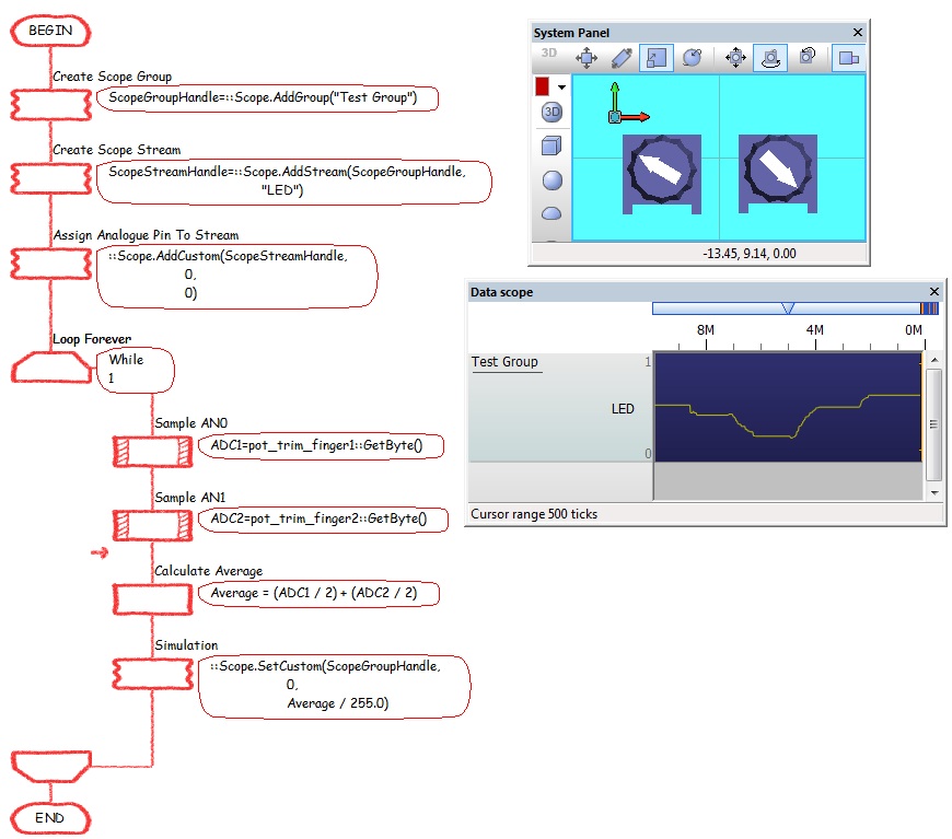

Adding an custom value to a stream

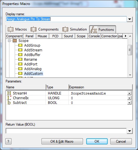

A custom value can be assigned to a stream object handle by using the AddCustom function call. The function requires the stream object handle, the custom channel index 0-31 for each stream handle. The subtract parameter allows you to add or subtract multiple signals on a single stream.
To create a single custom stream we can simply call the AddCustom function like this.

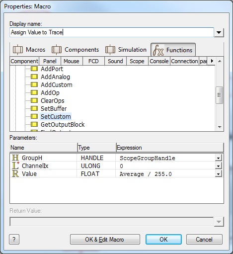

The data for a custom channel cannot come from a digital or analogue channel automatically so instead we have to manually pass the data to the custom channel. This is done by using the SetCustom function call. The value passed should be a floating point real number in the range between 0 and 1 so to convert a byte variable we have to divide by the value 255.0.
Here is a simple program to track the values of two analogue input signals and then calculate and plot the average between the two readings.
