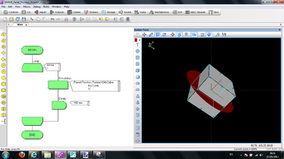

The screenshot from Flowcode v6 below shows a cuboid with it's internal axis shown (red is the X-axis line), and also a circle that cuts right through the cuboid's X-axis (see example section below for links to the file) When the program runs the cuboid rotates along it's X axis. Note also incidentally the cuboids axis is also the same as the world axis but this might not always be the case.
