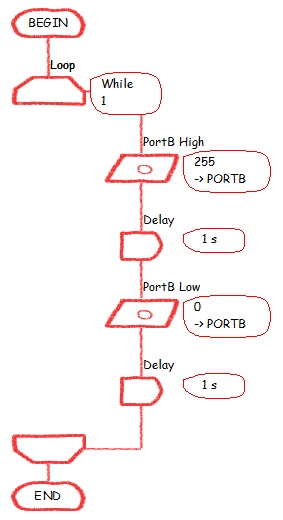

The one second flasher program simply consists of a loop, a couple of delays and a couple of output icons. The idea is to switch an output pin on and off to which a LED and series resistor (200R - 1K) can be attached to confirm if the delays are approximately equal to a second. The likelihood is that the delays will be either bang on one second or will be way out confirming there is a configuration issue.
Here is a example of a one second flasher program.
