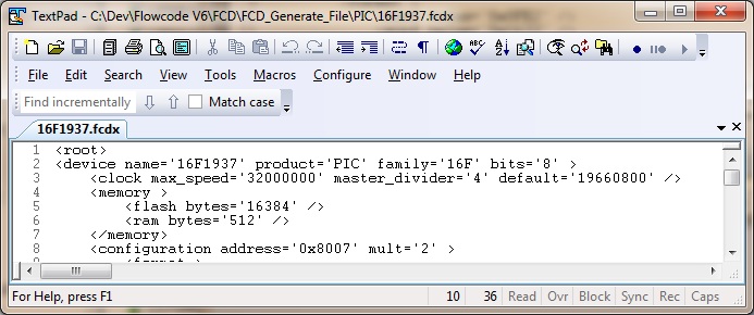

The FCDX file is similar to many Flowcode file types in that it is XML based. XML is basically tagged in a tree style hierarchy. We can open the FCDX file using a text editor to see the contents and see the paths to use to collect the data we require.
Example FCDX contents.

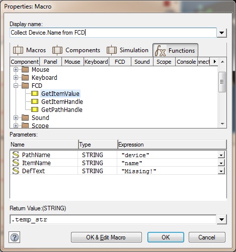

To pull out the data from the FCD you can use the Simulation FCD Functions. This example collects the device name and stores it into a local string variable.
