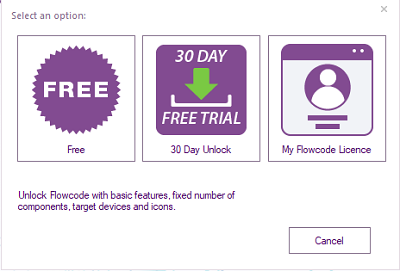

When you first load up Flowcode you will be present with this activation screen:
You can also access this same screen by going to Help >> Manage Licences from the Flowcode main menu.
Note that if have used your 30day trial then you will see an additional Free icon
If you would like to use the trial or have purchased a Flowcode key, then you will need a Matrix account, you can register for the site here:
Please note that the User Account is not the same as the Matrix User Forums account so your forum user name and password will not work to activate your copy of Flowcode.
- If you click FREE version, you will activate Flowcode in free mode and will need to enter no more information but will be using the cut down limited version of Flowcode.
- If you click on TRIAL you will be asked to enter your username and password, once entered and confirmed this will activate the 30day fully featured trial, this trial is ONLINE only, and if you go offline you will revert to the FREE version.
- If you click on the My Flowcode Licence then you will be prompted to enter your username and password to apply your personal licence to your Flowcode installation. You can do this using the online method or download the offline licence separately, instructions on doing this will be later.
