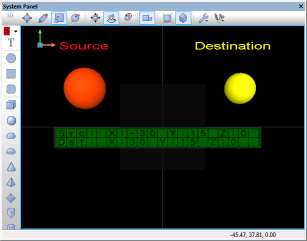

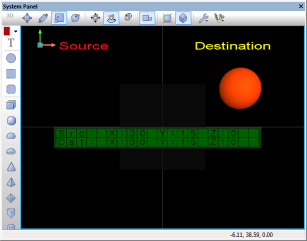

From the SimulationAPIExamples folder load SIMAPI_Panel_Position_SetCoords.fcf file into Flowcode. In this example there are two spheres (sourceball & destinationball) and a LCD showing the coordinates of each sphere. Every two seconds the program will move the red sphere to the coordinates of the yellow sphere, and then return the red sphere to its original position. The red sphere is slightly larger than the yellow sphere. This is purely to illustrate the red sphere moves to its correct destination (if the spheres are the exact same size then you may or may not see the red sphere properly as the program is rendering two spheres of exact dimensions in exactly the same coordinates)
The screenshots below show the effect and also highlight the code used by the example.
