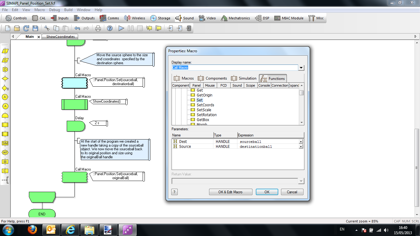

Flowcode example file
From the SimulationAPIExamples folder load SIMAPI_Panel_Position_Set.fcf file into Flowcode. In this example, The screenshots below show the effect and also highlight the code used by the example.
