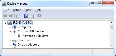

When the driver is installed correctly you will get your device showing up in the Windows device manager like this.

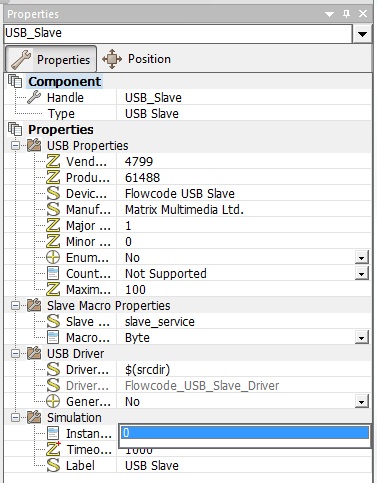

Here is an example file which is designed to run in simulation to communicate with the connected embedded device. The instance property will have to match the USB instance for the embedded device to allow the communications to work correctly. FC6 Icon.png USB Slave Simulation The USB Slave instance is selected by selecting the USB slave component on the panel and setting the instance property.

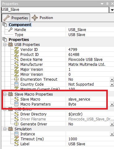

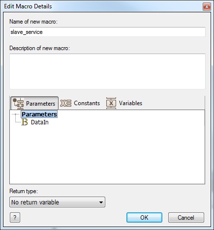

When editing the USB Slave examples the slave service macro needs to match the setting in the USB Slave properties as shown below.
Slave Macro Setup
Slave Properties

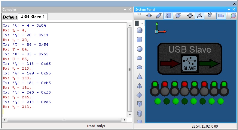

Example console showing the data passed between the simulation and the embedded hardware.
