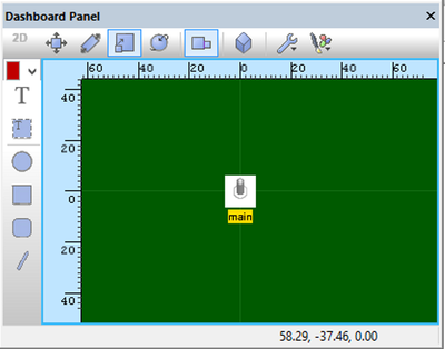

- Make sure that the Dashboard Panel is visible. If it is not, then click on the View menu and tick the check box next to 'Dashboard Panel'.
- Select a suitable color for the background, such as dark green (red=0, green=128, blue=0) by clicking on the 'General options' tab.30px
Add the switch
- Click on the 'Inputs' toolbox and locate the 'Toggle Metal Panel' switch.
- Click on the down arrow next to it and then on the 'Add to dashboard panel' option.
- The switch appears at the center of the Dashboard Panel.
- Click on it to select it. Its properties are shown in the Panel Properties.
- Click on the 'pin' property. A pinout of the microcontroller appears.
- Click on pin 'RB0/Int' to connect the switch to bit 0 of PORT B.
- Add a label to identify it (as there will be others!)
- To do this:
- Click on the colored rectangle at the top of the vertical toolbar on the right-hand side of the Dashboard Panel.
- Select the color black.".
- Click on the text icon, (the letter 'T') and drag it onto the Dashboard Panel.
- It may not be visible at this stage, but the Panel Properties will show it as the object called 'label', and list four properties - 'Color' 'Background', 'Font' and 'Text'.
- The default text content is 'Please Change Caption". Click on this and overwrite it with the word "main".
- In addition change :
- the background color to yellow (0x00FFFF);
- the coordinates to 'X'=0, 'Y'=-10, 'Z'=0;
- the scale to 'Width'=5, 'Height'=5, 'Depth'=2.
- The Dashboard Panel now resembles that shown opposite:
