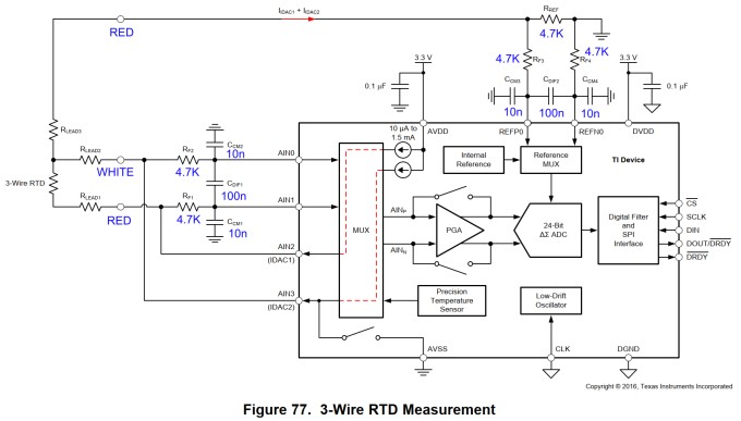

Example use case of a 3-wire RTD to read high resolution and high accuracy temperature.
FC6 Icon.png ADS1220_Test
Example circuit schematic complete with component values. RREF should be a high accuracy resistor with a low PPM.
