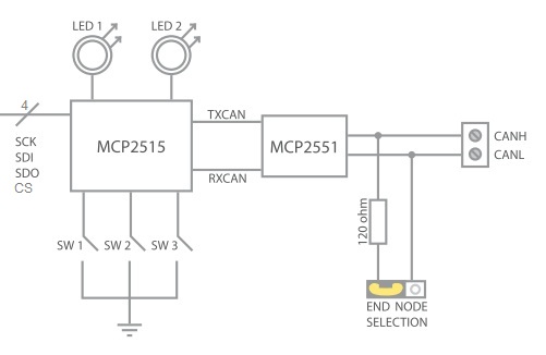

Internal CAN schematic

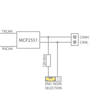

External CAN schematic
