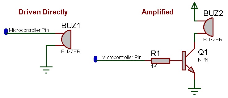

Depending on your Buzzer you may need to amplify the signal from the microcontroller using a NPN transistor or N channel FET.
